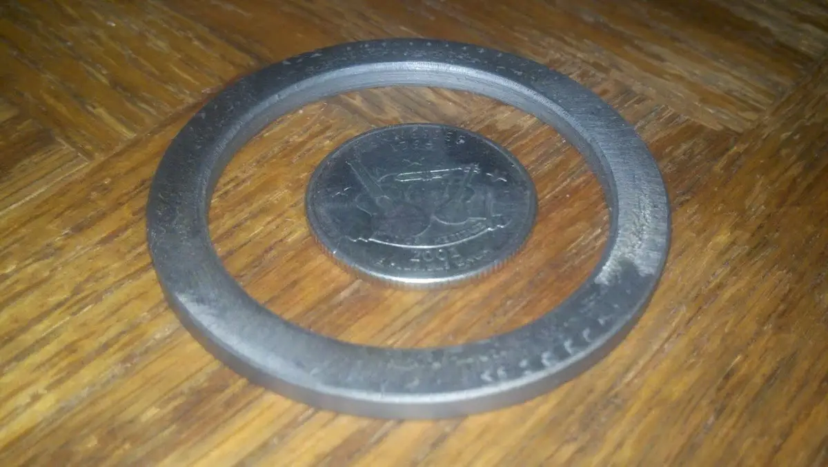

Since my plastic piece inside is not broken, I have found that the source of my problem is indeed the flat coil spring that I initially suspected. Other people are fixing this by adding washers to take up the slack that the coil spring used to take up.
I am going to:
A. Try to stretch the coil spring to give it some life back.
B. Take a coil spring from another hub and add it in there so I have two.
C. I am going to add either one or multiple washers like other people have done to fix it.
The two threads that were instrumental in finding this were these:
http://www.explorerforum.com/forums/showthread.php?t=149326
http://www.ford-trucks.com/forums/581318-4x4-in-1997-ranger-doesnt-work.html
The cause of my problem was the little flat spring underneath the piece with the three "wings" had apparently squished over time which means it doesn't have enough strength to align the pieces properly. I had my buddy machine me some specifically sized washers to fit just underneath the three wing piece to take up the slack. My hubs work like they are brand new after that.
