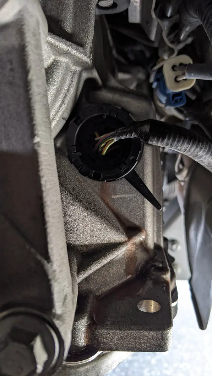

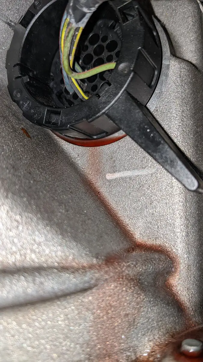

Hello, my ATF is leaking. I took some photos right about the transmission fluid pan. Not sure what this part is but this is the source of the leak. Is this repairable?
Thanks.
This is the bulkhead sleeve and is a part that can be replaced. The OEM part can be bought for less than $20 and I recommend buying this over a third party knockoff. Here is a link to the part on Amazon. A video detailing the repair is below. While you have the pan dropped you should replace the transmission filter.
The 6R60 and 6R80 transmissions are very reliable and at 230k miles a change of fluid and filter is probably way overdue. The most costly part of the repair is the transmission fluid to refill it. Be sure to only use Ford OEM transmission fluid. Especially since you would be mixing two different brands of fluid if you don't. You should buy the fluid from a Ford dealer because they will know the right fluid type for you to use. I think they might have changed the fluid specification for the 6R60 transmission to Mercon LV. Also, very few auto parts stores carry Motorcraft brand transmission fluid and I wouldn't trust them to know what the current fluid spec is for your transmission.
This video shows what is involved with a pan drop and filter change for your transmission. This has to be done to get to the bulkhead sleeve to remove it.
Lastly, I recommend you supplying the filter, bulkhead sleeve and transmission fluid to the shop if you aren't taking it to a Ford dealer. Repair shops usually go the cheapest route for parts and fluids which usually means they use lower quality substitutes for quality OEM parts and fluids. For something as delicate and expensive to replace as a transmission, you want to use quality parts and fluid.

Good for you on changing the AT fluid that often. Most people never change it at all. Removing the sleeve isn't hard. As the guy in the video states, just be careful of the pins where the plug connects.
