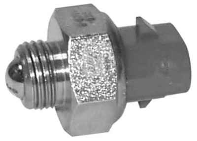

Does this sensor have an official name? I'm having difficulty looking it up online.
That doesn't look right. It looks like this:
Local auto part stores should have it in stock.
Sounds like I just need to crawl under there and take it out and run it down to the O'Reilly's, then...
Thanks, Brian.
