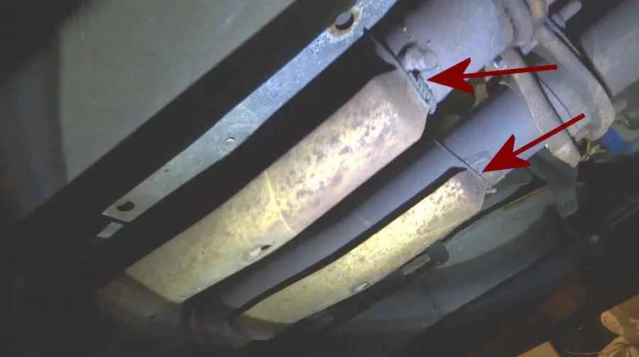

I checked out the heat shield on the cat last night. I noticed one of the pieces that holds it on (I think its welded to the cat) was gone and the whole shield had been pushed up against the cat. I'll take some photos and post them a little later. So I bent it back and drove a few blocks as a victory lap before it started rattling again. I guess one more detail I didn't think of or remember is that it's only doing it once it warms up a little bit. If I let the truck sit for a day or two and I get in and start driving it won't start rattling for like a couple of minutes.
I just noticed the one thing but I didn't look over the whole cat yet so I'll let you know if I get it solved.
