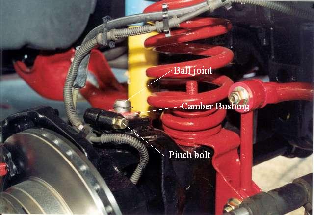

How do i get the right replacement part( left lower ball joint ) is there a difference in lower ball joints. I have a 4x4 with a lower 2 wheel drive. what is the right replacement ball joint part. And how will the auto part store know what is the right part for me. Is there any additional information they will need?

What exactly is a "4x4 with a lower 2 wheel drive" :confused:
Most (99.9%) 1st generation 4x4 Explorers (91-94) came with a TTB Dana 35 axle as seen in the picture below. The upper ball joint is smooth (not threaded) and held in place by a pinch bolt. The upper ball joint on a Dana 28 axle (not shown and extremely rare on an explorer) is threaded and held in place by a castle nut and cotter pin.

Check out the TTB Restoration Thread for lots of info, part #s, and pics on rebuilding a Dana 35.
Dana 35
Ball joints (Moog) greasable Rockauto.com
Upper (2) K8546
Lower (2) K8563
