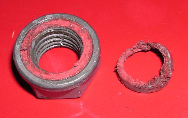

I from time to time get asked if it is ok to reuse band adjustment locknuts. I always hedge my bet.... the threads will be a close enough fit to prevent MAJOR leakage in my opinion, and the nut also would slow it.... AND you COULD add a little silicone or RTV sealant at the case/nut juncture....
Well I just finished a tranny and I had reason to want to try something on adjustment, so I removed a brand new lockbut I had just installed. I always lube the seal and had on this one... but when I removed it it looked like this:
Here is it beside a brand new one (the little ring in the middle is what I pried from around the bolt where it entered the case, making a NICE seal.
So, your call. Thought this might be instructive. I think you could use some other sealant and watch it for leaks, but clearly the rubber sealing ring gets totally fubar in the process!
There are a couple of alternatives that could be done instead of discarding those nuts. One thing that could be done is to just pry out those seals, and use very thick O rings. Another thought would be to use either fiber, or plastic washers that are used on drain plugs. A similar idea is to use the rubber coated washers that are used on the FWD AXOD. I use those washers on the A4LD's inner bell housing bolts. I don't like those small O rings that are pressed into the head of those bolts. They rip very easily. I use the rubber coated washers in addition to those O rings to prevent leaks in that area.

Still a good message. FORD wants you to buy NEW bolts, all for a new O-ring. Buy the O-rings and reuse the bolts.
Where can I buy these? Dealer? How many do I need? 2? How hard are they to replace. I might just replace mine cause it's a hassel to get to the tranny shop.
Why don't you just replace the seals with O rings instead of throwing out the whole lock nut? As for ease of replacement, this is probably one of the easiest parts to replace on this transmission. There are 2 of them located on the driver's side of the transmission. Any place that sells transmission parts should sell it.
