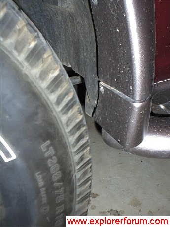

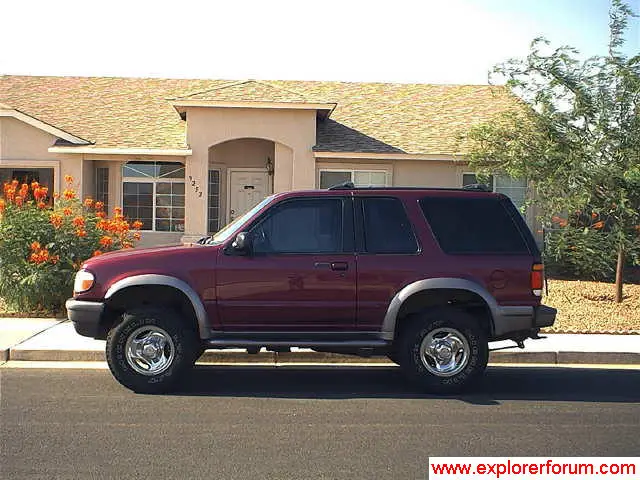

I have a question for you...did those tires fit okay on your factory 7" rims? Those are really wide for a 7" rim. It gives me hope if they fit okay.
BF Goodrich rates them for 7.5"-9.0". Discount Tire didn't have any problems mounting them and they seem fine. I've gotten somewhat aggressive with them on the street and haven't had any problems. The one thing I do like about them is they ride a lot more comfortable than my 265 75R16 Michelin LTX ATs (load range C) even though they are a load range D. I don't know if it is because my Michelin's had 50K on them (still had about 1/4" of tread left) or if it is because of more air volume in the tires. Whatever the case, they ride very nice.
