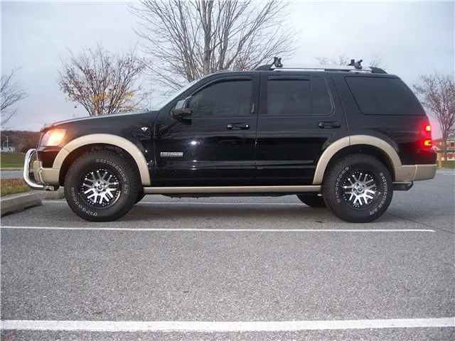

Finally got all the pieces together and washed the Ex...
MAMBA M3 17"x8", with 20mm offset
Firestone Destination A/T 265/70R17
Hubcentric Rings
Gorilla wheel locks
Wheels/Tires/TPMS Sensors came to $1376, balanced and shipped, from Mr Wheel Deal (http://mrwheeldeal.com/a/). I was a little apprehensive not going to some of the "major" Internet vendors, but this guy is 5-star in the book of customer service! Answered all my questions (a lot of them!), in a timely manner. I'd do business with him any day...
The Hubcentric Rings were $55.95 from JustForWheels. The 70.3mm ID was a little tight to install, considering a fair amount of rust layered the hubs, but a rubber mallet and some polishing with a Dremel took care of that.
The Gorilla wheel locks were $47.99 + $9.95 S/H for a set of 20 from SummitRacing.
Altogether, baby got a $1,500 makeover.
I'm still waiting for the Ford TPMS tool to retrain those darn annoying sensors, but I had to show off the girl.
With the 20mm offset (OEM was 44mm) and the wider tires, the package is just about flush with the fender trim:
The Destination A/T are as aggressive as I want to get:
There is some minor rubbing at full turn, more noticeable in reverse, but I should be able to move the black shroud back a bit to clear:
Inner clearance is not a problem:

Ever think about getting the trim painted black?
Not really, to be honest. I like a little color in there. I am thinking about painting the EB "gold trim" to black though.

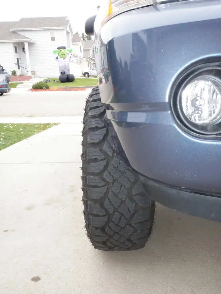

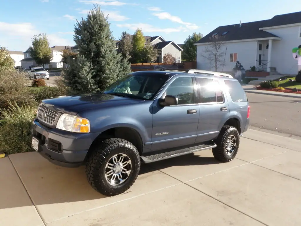

Looks kinda like millertimeX17's explorers wheels:
I think you need a 3" body lift!

Yes to the look (kind of inspired me, I think those are Mamba M2), but not likely to the lift, at least not a whole 3". With the larger diameter tires, that would end up being something like a 4" increase. Some of the parking garages around the Washington, DC area were made for midgets, I barely clear them as it is! Now, maybe the Rancho 1 1/2 Quicklift... Christmas is coming soon afterall ;)

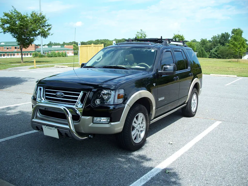

How about some pics of the front? I want to see the bull bar. Be nice to have something to get pulled out by in the front since ford didnt put tow hooks on these.

Those wheels definitely compliment your truck well. Mine are Vision 375 Warriors by the way. I saw your signature said you have dual exhaust set up. Do you happen to have any pics of your setup?
Those 375 have an 18mm Offset, right? Mine have 20mm. I think that 18-20 gives the Ex the wider stance that it needs, compared to the OEM 44mm. It's only about 1" wider on each side, but I can definitely feel I'm getting better stability.
I posted a few pics of the exhaust setup here: http://www.explorerforum.com/forums/showthread.php?t=260221 and a few more here: http://www.cardomain.com/ride/3355821/3. Oh yeah, no spare tire anymore...
Mine actually have a 0 offset. They stick out about 1.5". The offset looks much more aggressive with the lift on top. I dont carry a spare either. I'm waiting to get a roof basket to carry one in.
