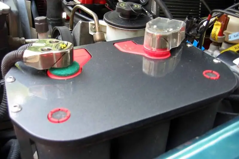

Optima are "hit and miss" on the quality front. I had a Red Top die less than a year after I bought it and know of many others that had similar issues. I'm using a replacement Red Top now and have had better luck with it, but I tend to suspect how well it's holding up. My car has been hard to start at times after just having the dome light on for an hour or so while wrenching. I also currently have a Yellow Top. I sort of alternate between the two batteries. I can't say with certainty that one is better than the other. The only reason I've stuck with Optima is that I've removed my stock battery box and have a billet battery holder made for Optima batteries in it's place.
I use a C-Tek charger with both batteries. They're kickass chargers with a setting just for Optimas. I was having issues with the Red Top a while ago and the charger seemed to rejuvenate it.
i can't remember what model it was. these are times i wish i was state side lol.
celly where did you get that battery pan/box for the optima from?
eBay
Use "Optima" and "Billet" as search terms and you should fine them. I think my seller might still be around. I discussed the box Dead Link Removed in a review a few years back. I had the top powdercoated this past summer.
EDIT
Seller is still around. Go here. Still has perfect feedback.
