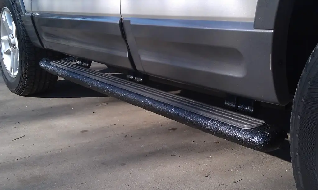

Just Painted My Rusted Up Running Boards With Bed Liner
What did you use? It looks like its the rubberized type rather than the stiff gritty stuff.
I used Herculiner It Feels Rougher And More Textured Then It Looks
Prep for paint
Thanks for the post.. This is exactly what I was looking to find on this site- I am a novice but this seems simple enough. What did you do to prep the boards? Did you dig out the rust areas or just sand it ?
Nothing like reviving a year old thread! But that's ok, I was just going to do it too. My 01's are pretty bad, as I believe they actually get water in them, and they sit. I was going to use a wire sanding disc to take off the surface rust, pop out the plastic tops, then spray. I love this idea of using bedliner spray!
I blasted mine and had them powder coated. Turned out great!
