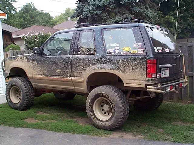

My Sportster as it evolved over one year of on and off modifications.
Before:
and after:

got my winch... Mile Marker 12000 should do it... and the whole set-up should be installed later in the week...
Yeah, 2nd gen. I haven't looked into anyone else who might be able to do it. Yours is the first custom one I've seen that I like.
This guy fabs lots of things for the off-road crowd in and around Warsaw, Poland. He's pretty good at it too... just checking my bumper and looking it over you won't be able to tell that it was built at some small shop.
BTW... my truck runs great now... I still have to do something about the rear spare tire carrier... there is a possibility that I would sell the rear pre-runner bumper and go for something tougher... bigger... like the ones Kennesaw Mountain Accesories made for us about a year ago. Will see...
:cool:
if I only knew before... I was thinking about selling it since I had no real use for the spare tire carrier... little design flaw... and finally decided to cut it off...
for now the bumper stands on it's own - I have installed an extra set of lights in it and brackets to mount hi-lift jack...
coryL makes these... that was his creation. Visit Off-Road Tube Work Bumpers, Sliders Forum and ask him...
mine was not built properly - I had a problem with it from the beginning... had to cut the latch off since I couldn't close/open the rear hatch...

Dre said:
Updates:
6" Skyjacker Stage II in front;
SOA in the back with new axle (4.10 and disk brake upgrade);
Front end with 4.10 and Powertrax lock-right;
33" meats on 15X10 RockCrawlers;
Manual hubs;
Pre-runner rear bumper with spare tire carrier;
Headman headers with turbo exhaust;
KKN intake with filter;
Bosch plugs and wires;
addition of overhead console;
Surco roofrack;
rewired interior to handle more gizmos;
200A alternator.
Coming very soon:
ARB style bumper with a winch;
CV joint drive shaft modification;
traction bars...
more, more, more... never ending quest.

I have taken down "tupperware" - mouldings that ran along the bottom of the door and around fenders since I had to trim front fenders and cut lower portion of the rear rocker panel. Overhead console was purchased on ebaY... but when you buy make sure you know what you're getting. I noticed people selling complete outfits now (overhead console with mounting bracket and temp sensor). When you buy console only you'll have to buy bracket and temp sensor seperately. If console comes with no plug (electrical connector) don't panic. I soldered all my wires and ran seperate wiring harness to the console itself... no biggie. As for additional mods for looks only? There should be plenty.
Need more info just ask.

Chico... bumper was built by CoryL off this board. Look into Tube works forum for more info. So far I had no problems with cops giving me trouble... truck is great so far... and here's an updated pic:
