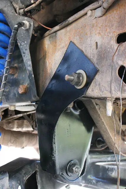

I ran duff drop brackets for many years and never had an issue. They had an extra piece to help reinforce the bracket and keep it from ripping (pulling backwards).
I did go to the BTF Cut and turn beams BUT when I did that I added the same style reinforcement that the Duff bracket had to the stock brackets. Even the stock bracket that I put on was starting to bend/rip some so I can see how drop brackets without that reinforcement break.
Here are a couple shots of the bracket modification I'm talking about.
First is my stock bracket with the modification. I matched that bolt going through the side of the frame to the same spot that Duff had it. I'm using one of those nuts with the wing on it so I don't have to get a wrench inside the frame.
Modified stock axle pivot by maniak_az, on Flickr
Here is a shot with my bracket on the left and the Duff bracket on the right.
Duff versus Stock Passenger side drop bracket -2 by maniak_az, on Flickr

I do agree though, some reinforcement of the bracket(s) might be all that is in order here (and maybe boosting your lift height a little via washers to get the brackets up higher if your suspension is sitting a little low). It's very possible to have drop brackets that far exceed the strength of the stock brackets (as is the case with Skyjacker and James Duff brackets).
Awsome thanks guys bracket coming off tomorrow and will be reinforced :-)
