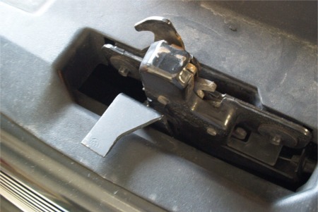

I fabricated an L bracket and bolted it to the stock hood latch. That allows me to unlatch it in the space between the top of the grill and the hood. Same way that 98+ latches are.
Hey. U have any pictures of that, How much work did that take you to do that project?
Took me about a half hour. Started with some flat stock and just bent it over, cut the groove in the side to make it look a little more like stock.
Alright man, I like it and it looks good. Thanks for the info....

I agree with Hartman. I got the job done and it looks good will post pictures soon.

How does the bracket bolt on? On my truck the part that moves is at the bottom and you couldn't really bolt it on. You'd need ot like, weld it or something.
