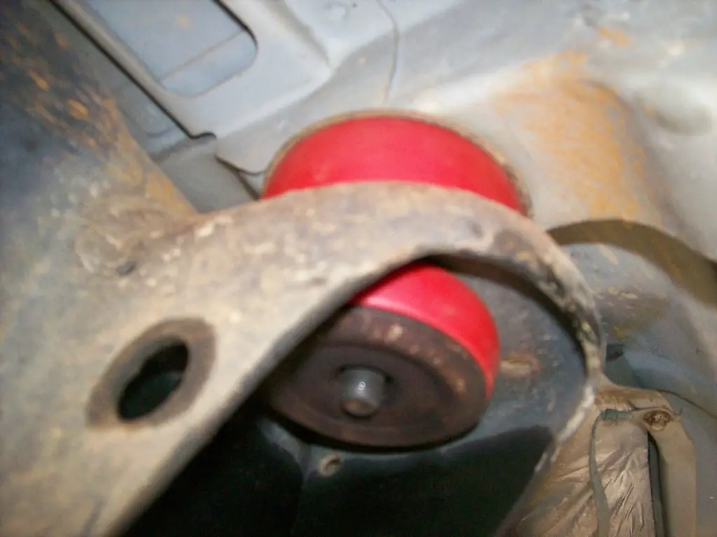

Ok, I am in the middle of the bushing replacement and have pictures to show what was done so far and how that I had done it.

More pictures. I woke up this morning early because I hadn't done anything on the truck yesterday, I had to get a a/c guy to come out to look at it, I must have dreamed of getting to D bushing out because I was determined. I looked around the barn and found a old tire iron that I didn't have any need for, I cut the angle off and now I had a punch. I had taken the bolt from D bushing and threaded it from the bottom up just enough to come over the end of the lower bushing hardware and proceeded to hit on the bar to loosened and finally off.

EXCELLENT work and pics Kajun! Body mounts have never been considered an easy job, and it just goes to show
when you put your mind to something almost anything's possible. You are an inspiration to all of us, especially after reading your post from last year. Congrats buddy, now finish the **** job. LOL ;)

Thank you swshawaii, I plan on finishing it soon, maybe this weekend. A lot has changed for me from 2 years ago until now. Having congestive heart failure really has taken it toll on me physically. I try to move as much as I can everyday to feel useful, trying to pull my weight. When I first read about body bushing when I had joined explorerforum, I called Ford dealership and inquired about how much it would cost to change all the bushing. I was amazed @ what the parts and labor were. There are some things I would never tackle on a vehicle such as tearing down a motor or transmission, There would be extra parts, bolts and nuts, after I would be done. LOLOL. But replacing bushing, not a challenge. I knew it would take me some time which I have plenty of till the day I go home. I am happy with the progress and really, I can't thank you enough, HELMUT RONER, koda2000, MidnightRebel, and many others who's thread I've read. This is the first time I have ever changes bushing before and man, am I loving it! So Guys, THANK YOU!
