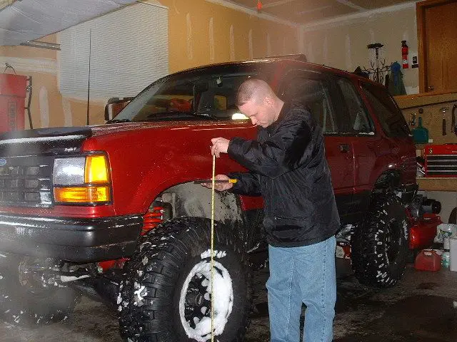

Here are a few of the pics from that day.
before
After:

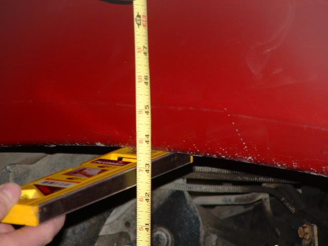

And the fender ht after 1" bodylift is
