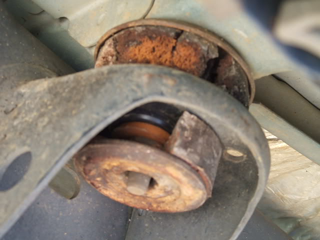

If the body mounts look like any of these, then you probably should consider replacement:
You don't need to measure the body mounts for height or anything like that, they will obviously be compressed due to the weight of the body, but it's more about what shape they are in, as a mount that has been compressed too much will have cracks and obvious visual signs that it needs to be replaced.
