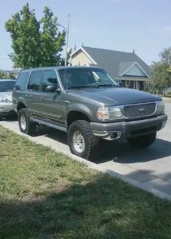

With the combination Blee posted your truck would sit like this, this is Doug's a moderator here.

That's correct, you won't need steering extension with the lesser-known 2" BL. At that point you'll have 4" of lift w/ TT and shackles and be able to run 33's with very minor trimming
