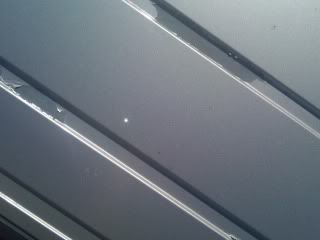

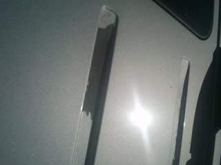

here are 2 pics of my roof... these are the largest chips in the paint...
the first pic, is hard to tell because of the lighting, that is the only spot of rust so far on the roof...

So I can maybe better help you, is there still paint on your X (where it has chipped), or is it down to the metal or primer. The larger of the 2 chips does have some rust like you mentioned.
Mines been like that for a year now. Dealership said tough luck. Quoted about $400 to repaint.

If you plan on going down to bare steel, I would use a epoxy sealer primer... Then it will have the best protection against corrosion, not as good as factory E-coat... but good...
The main thing when repainting is prep.. making sure the area is clean and dust free... Here in class we would do 220,320, prime, block with 500, then clean again, then final coat spray...

My roof started like yours, now there is almost no paint in any of the channels. A real PITA I tell you. And its spreading. De-lamination is what they call it. Poor prep and paint is what I call it.

Well my 05' has this problem too. I just sanded down all the channels, two coats of rust prof/primer, two coats of touch up paint. The rust was only surface rust thank god, and it came out ok. Noone is going to look up there except me. This is a PITA job, I had no step ladder of any kind. So it was standing on my rear seats, and holding on the roof racks. Just take your time, tape off the area for over spray. Then have at it, its not a hard job too do. Its just a pain because of where its at. I can't believe how thin the paint is up there. It looked like only one coat was applied by ford.
Had the same problem on more than half of my roof. After sanding down rust and priming it I took some rostoleum silver outdoor and applied a few coats. Then clear coated and waxed and it matched pretty well, not that anyone can see it anyway.
