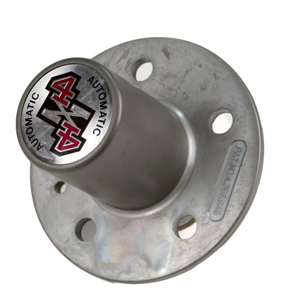

Well, Its not exactly a "Spare" per say, its a full size tire..on a truck that isn't my monster. The tire Itself is a 205/75 full size off another explorer (PS I do not have ANY idea why this explorer had 205's on it. from my understanding the stock tires are 225's or 235's), but mine are 235/75's. the only problem I have is that "Hub" piece don't fit through the center of the wheel. Its basically a cup what bolts to the the wheel and sits on this gear looking mabobber,where the rim goes over it. (I'm assuming this is the "lock/unlock" thing that turns when you back up to lock and unlock the hubs for the 4wd) Is it ok to run without the "Cup" thing. I just want to make sure the response wasn't in consideration of me running a "doughnut" type rim.
This is exactly what is NOT on my truck for the moment.
Its only being used in town, I just want to make sure I will not destroy anything important. Since the truck is in 2x4, does this thing matter? Thanks for the response!
ADDED: Also I put a cover over the gear spline thing on the wheel to keep crap out.

You'll still be OK....unless you plan on taking a couple hundred mile road trip or something to get to the shop. ;)
-Matt
Bingo! Thats all you really need to worry about, just to get it to the shop.
