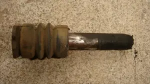

Sonic and Koda are correct. Do NOT use regular anti seize. This is what happens when you use it on brake hardware. A gummy, sticky mess guaranteed to cause binding and noise. Use only high temp silicone grease made specifically for brakes. Most higher quality pads have molded in shims so brake quiet compound is not needed. My98 I'm very surprised, I've always taken your advice.
