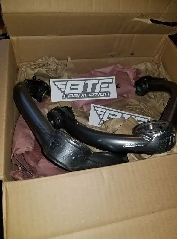

The Winter was a long and nasty one, but it gave me a chance to do a few things that I desperately needed to do to the Explorer. I FINALLY GOT MY BTF ARMS. Installation is a breeze with these things because Ford made it insanely simple to replace control arms.

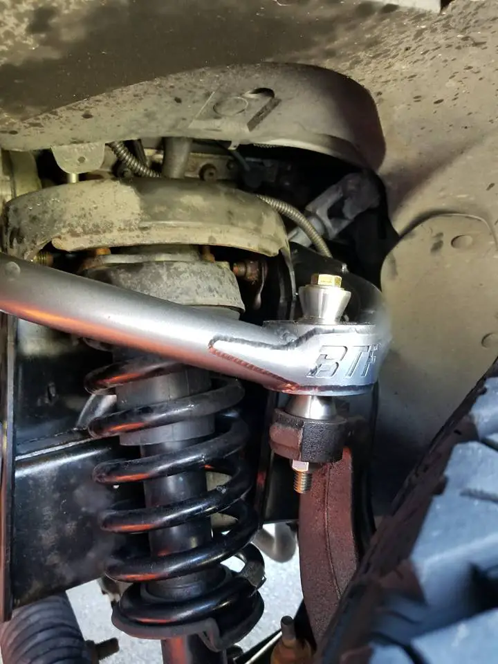

STEP ONE:Remove the 13m nut connecting the balljoint to the knuckle
STEP TWO: Remove both 18mm bolts holding the upper control arm in (has stopper on other end so you wont need grippers to keep from spinning
STEP THREE: Reinstall both 18mm bolts to BTF arms (Comes with 2 washers to create tight fit DO NOT USE HAMMER TO PUNCH IN)
STEP FOUR: It's a uniball rather than joint so insert both pins into ball and tighten 13mm nut back to the knuckle.
STEP FIVE: They are adjustable, so you will have to play with the camber to get them where you like, and get an alignment.
I understand I suck at explaining things, so if there is additional information that i missed please chime in. Thanks!

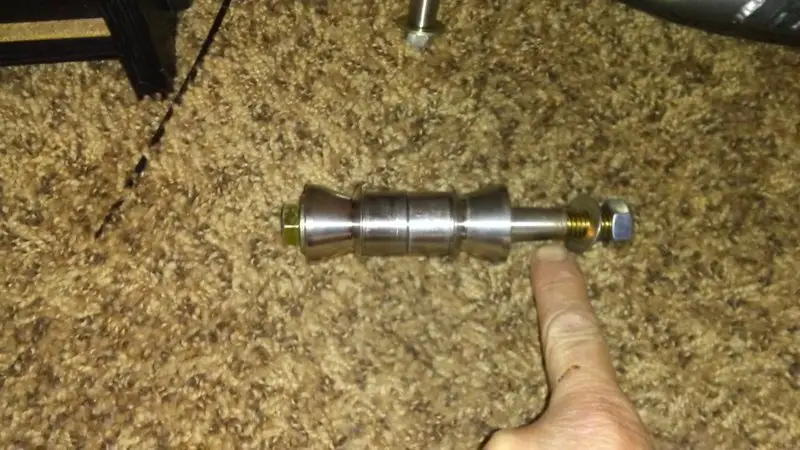

Was the taper on the uniball spacer piece right for your spindle? I tried to install these on my '10 Sport trac today and had to back out because the spacer did not fit the spindle correctly. Like it was over-milled.

Yes, the uniball portion is correct. I'm talking about the bottom of that spacer where my finger is pointing; the part that inserts into the knuckle, and then the 13 millimeter bolt goes through to attach the knuckle to the arm.
Turns out that BTF has been using the wrong dimensions for that taper piece.

Before you get too far into installing them, separate just one of your upper ball joints and test the fit of the piece my finger is pointing to in the picture above. make sure it fits into your knuckle snuggly. BTF had been making these wrong and were unaware of it. If that part is NOT snug in your knuckle, contact them. If they haven't sent yours out yet, chances are that they built yours to the new (correct) specs and you will be fine. But all the one's built prior are machined incorrectly and don't fit properly. Apparently many have been installed anyway and people are not aware of the problem.
Before you get too far into installing them, separate just one of your upper ball joints and test the fit of the piece my finger is pointing to in the picture above. make sure it fits into your knuckle snugly. BTF had been making these wrong and were unaware of it. If that part is NOT snug in your knuckle, contact them. If they haven't sent yours out yet, chances are that they built yours to the new (correct) specs and you will be fine. But all the one's built prior are machined incorrectly and don't fit properly. Apparently many have been installed anyway and people are not aware of the problem.
ahh! im sorry! i miss interrupted what you were saying. the taper is over milled as in: its to skinny relative to the knuckles taper. so unless you really snug the bottles which still isnt a great solution - there is going to be vibration and movement.

The guy at BTF was more than accommodating when I brought the problem to his attention. Any made after 4-29-19 should be correct. I would assume that any made, but not yet shipped, by that date would also be remedied prior to shipping...BUT CHECK!

absolutely right, gave brandon a call (super nice btw) and they are having the machinists manufacture new ball joints so any UCAs ordered or on back order are receiving them, thus my delay. - Rather have a good product tho!
