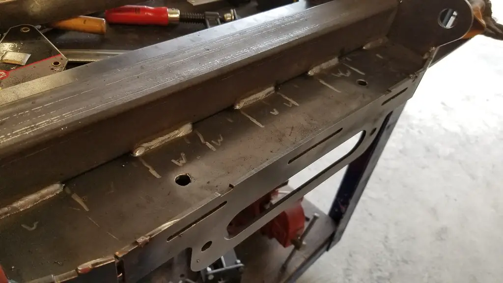

Before all the lower plates go on some of the areas need to be welded as you will not be able to reach them otherwise.
20180202_125737 by Matthew Dresselhaus, on Flickr
Then tack weld the lower pieces on and test fit it all.

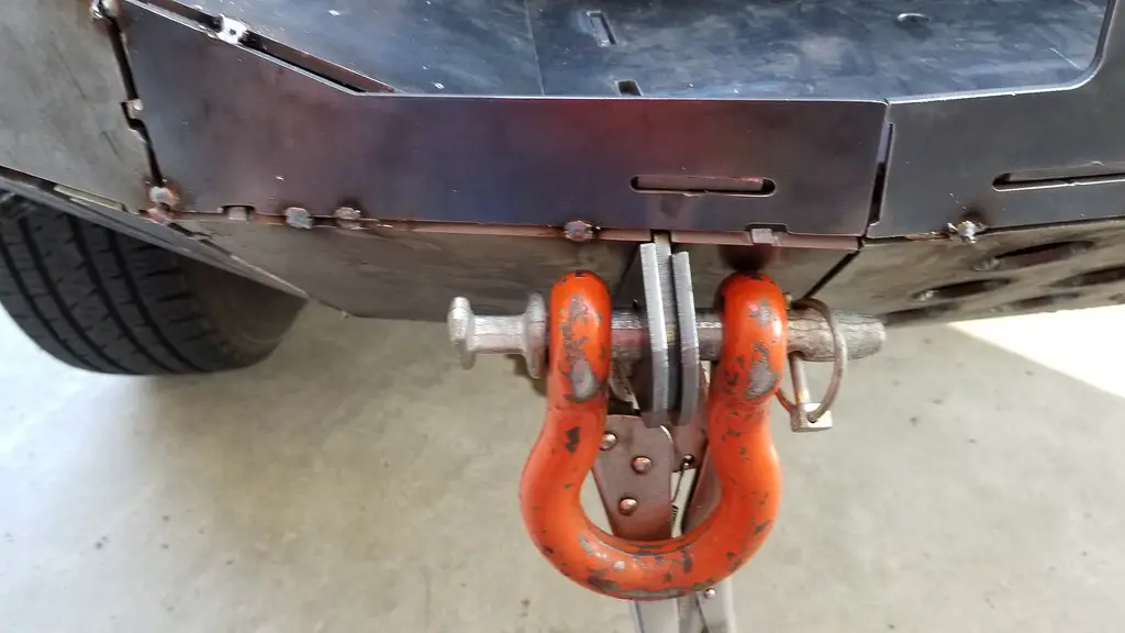

Included are shackle recovery points and notches for a hilift jack.
20180203_152325 by Matthew Dresselhaus, on Flickr
20180203_152047 by Matthew Dresselhaus, on Flickr
