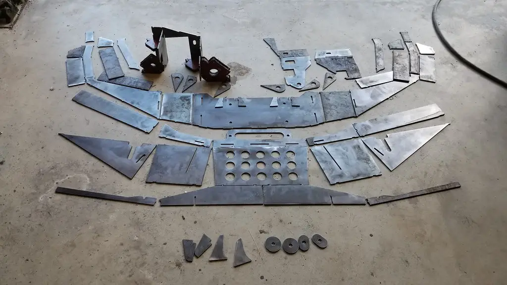

@RockRanger - do you make these kits? Could you PM me more info? I have a Gen2.
Thanks!
Do you do rear bumpers as well?

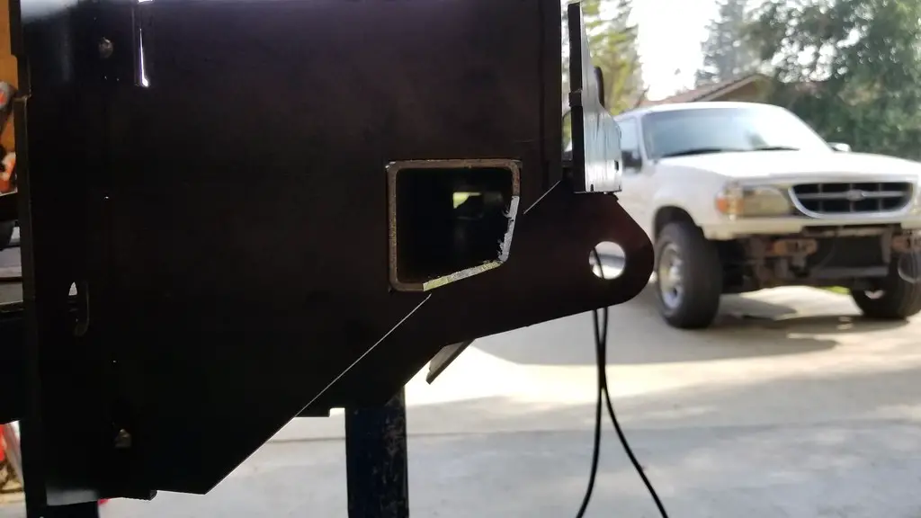

Does your bumper use the OEM mounting points? or is cutting/drilling involved? I ask because I had to do some cutting to the OEM mounts when I did my body lift.
Uses the oem mounting points plus another mount welded to the top of the frame.

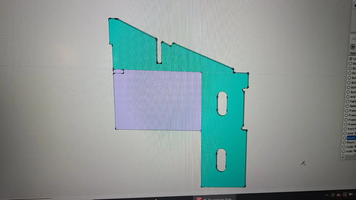

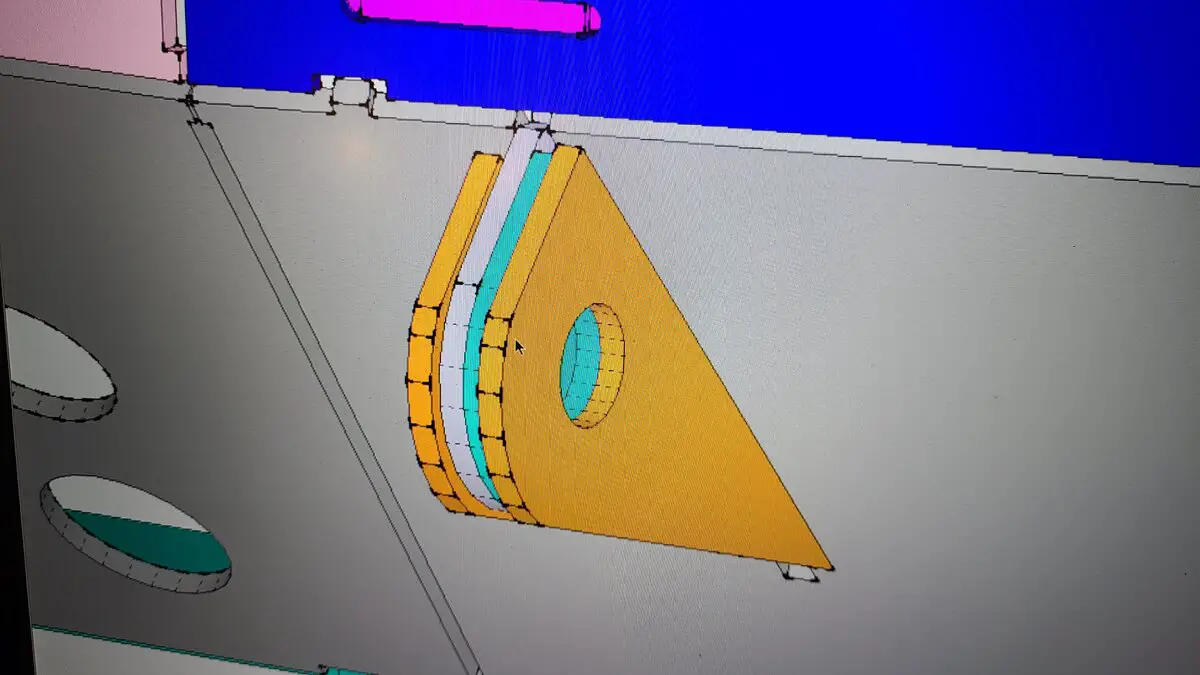

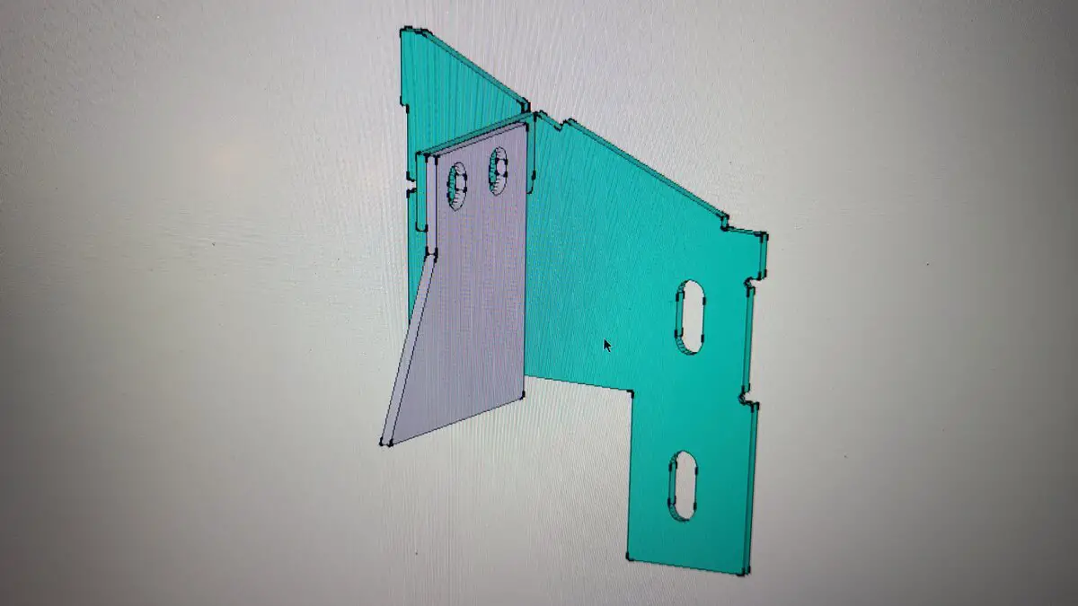

I think I'm about ready to start welding my kit up (very sexy kit By the way) and was wondering if you have a picture of the new upper bumper mount you talked about?
Is it one of the D ring looking pieces since it looks like you only weld one on each side of the D ring plate and the kit has 2 more.
It is 4 pieces for each shackle mount. Each is a bit different to allow for the angle of the bumper. The additional mount is shown here as for a 3 inch body lift. If no body lift then the gray pice will be cut roughly 3 inches shorter.
