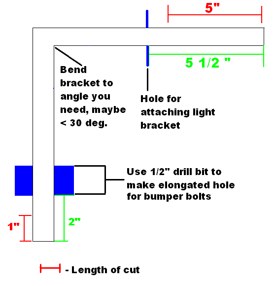

here are mine.
i did mine like "wisekise" cause the other way was WAY to hard to get to work, but this way work great no speacial angle just a good ol 90 (degree)
looks good, and pretty easy too huh!
i just had the steel laying around , but i bet you could find an "L" bracket at lowes or somewhere similar.

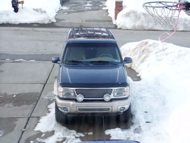

Here is mine for a 94 X on a 8x8 "L" bracket.

Heres the ones I just put on my EX. I used steel corner braces from Home Depot/ Lowe's and bent them in a bench vise til they fit properly
