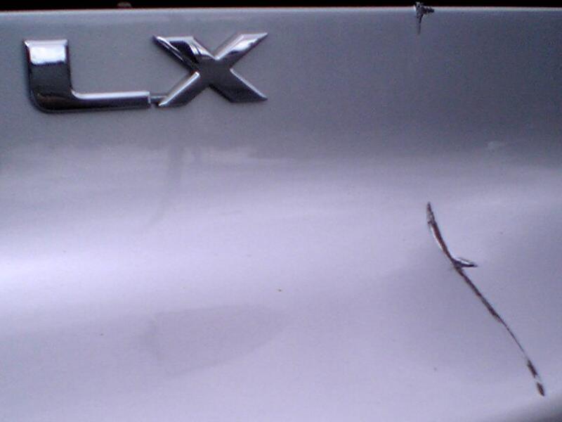

momix heres a pic of the damage..don't count my poor photography skills against me...but i tried to get a comparison with the LX badges to so can see where in location and in size it is.

That scratch is fairly significant.
It may cost a bit more.
Good luck looking for a good price.
You could probably save some $ by removing the bumper cover yourself.

Some but not much. I would imagine a civic rear cover remove and instal would be 1.5 at best. Far less and $100.00.
But money is money. a pair of 10mm, six phillips screws, seven push clips.
It is a way wasy task if you have a decent panel popper.

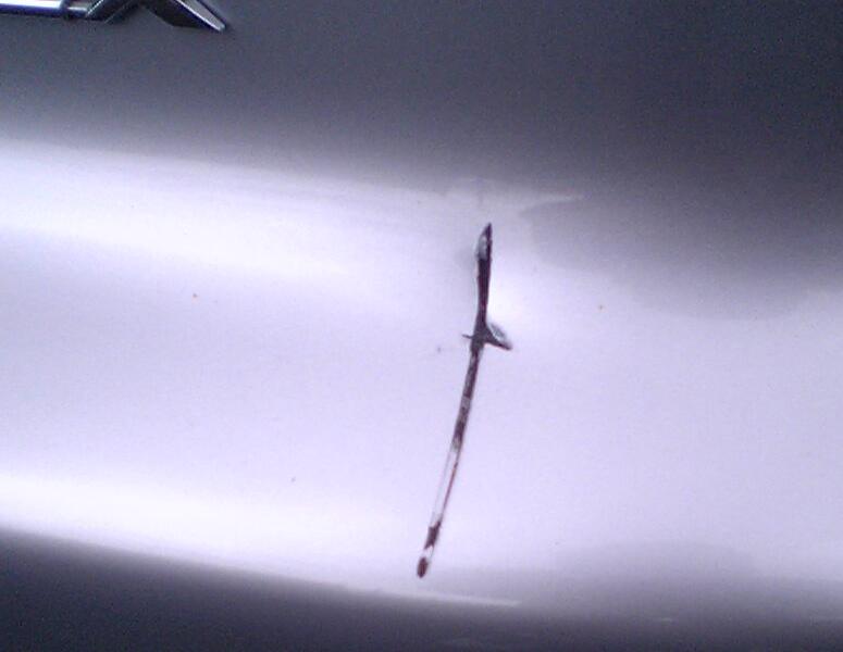

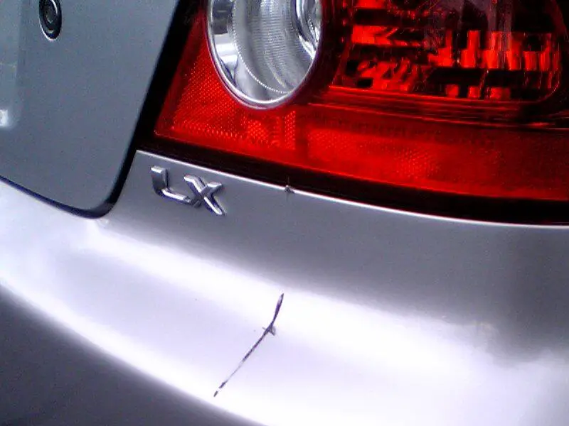

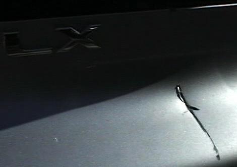

Monmix...would you guess it would/should be less than 300???
other pics of my stupidity

Couldn't that be filled and repainted? Has to be flexible filler out there. Then prime and repaint. I think that would be much cheaper than whole bumper swap.

I figured it could be just filled and painted....i would hope so at least
i'll have to get it fixed either way since its a lease and i don't want to buy it out at the end...
I figure since the paint isn't faded alot since its only a year old it may be easier for them to blend the paint in...then again like i said i know very little about body work thats why i posted this :)
filling and painting might still be cheaper than replacing.
Any thing you get from a junkyard is gonna be loaded with knicks and scratches any way.
Most any shop will give you an honest answer as to the cheaper route repair or repalce.
$300.00 is really a guess. I dont write estamates or deal with pricing, I just fix em.
