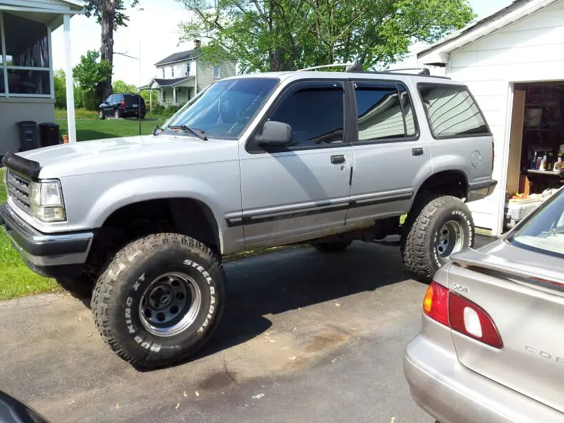

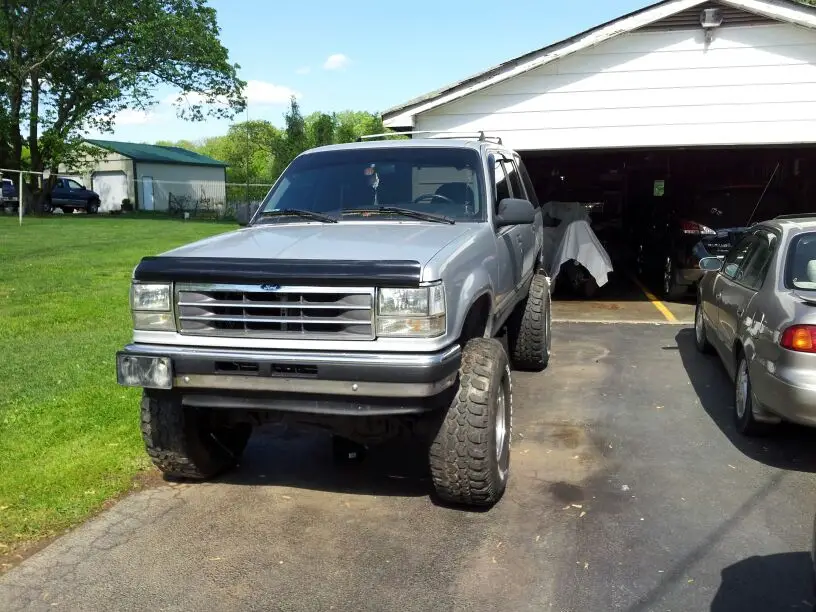

So this is the Explorer. After alot of negotiating i ended up getting it $100 Cash as is
Came with 2 rear dog legs driver and Pass to fix rust, and a Brand new unopened water pump.
