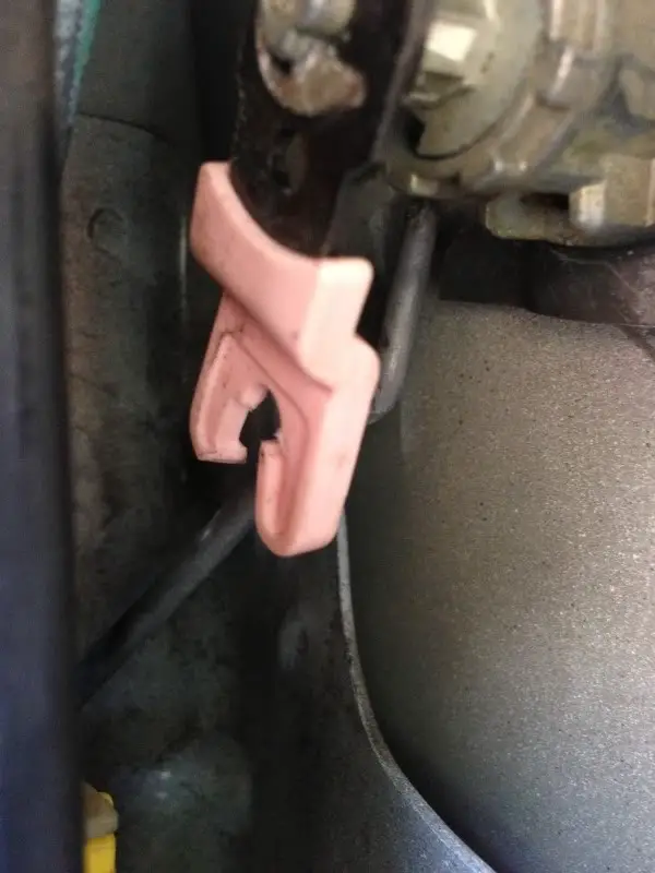

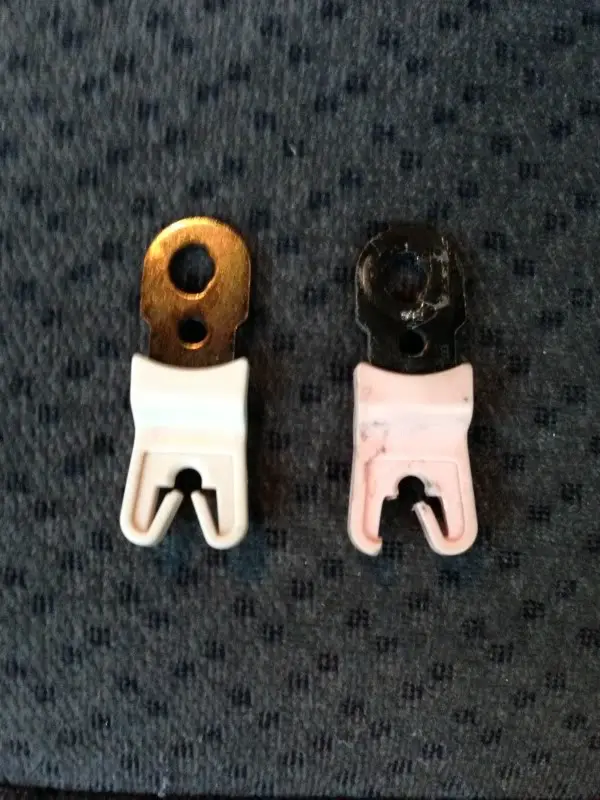

So I look my door panel off to inspect the locking issue and I have found the culprit. The little plastic clip the holds the metal rod in place is busted. Time to order a new one!

The issue with the Drivers door was the lock rod clip. Real easy fix, went to autozone and got a new clip, replaced the broken one, sprayed grease in the locking mechanism and any moving parts associated with the lock and it was as good as new!!

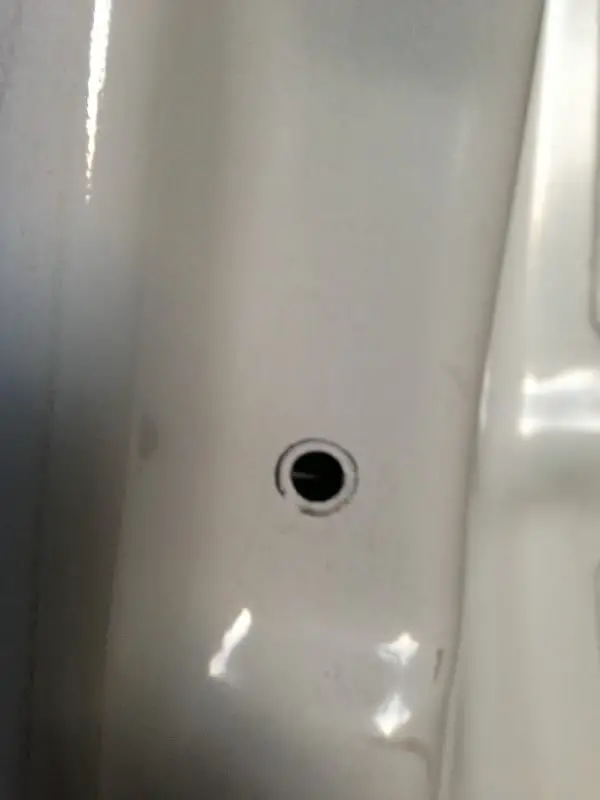

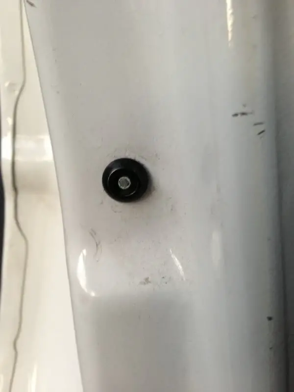

Now the issue with the Passenger side is the lock actuator works just fine, however its not mounted to the side of the door anymore, its floating free. Which enables the door to be unlocked but not locked.
Pics below show where the actuator is supposed to be mounted but not. I'm a little lost as to how to get this remounted.. Any thoughts?

Drivers Side (How its supposed to look)
Passenger (Broken mount)

Same thing happened to my passenger side lock. You will need to remove the actuator and drill out the broken rivet and nut and bolt it back in position. Be careful, plastic rod clips are brittle.
Bill
I just used a grade 5 nut and bolt with washers to mount mine. You can actually take off the metal bracket to drill it out. It sort or just goes around the actuator.
