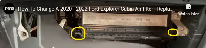

But the technician broke off the mounting tabs not retaining. Check the photo. The tabs circled in yellow are what’s missing. No where for the screws to go and nothing to snap into the retainer clips.
AHHHH. I missed that the first time around. If it moves and shouldn't, then duct it.
