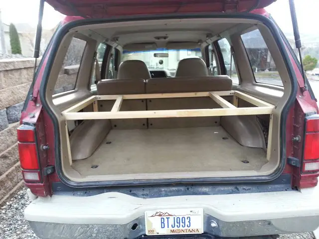

I wanted sth for road trips and sometimes for camping. So my idea was to build cargo/sleeping area.
I've decided to split it into two pieces so I can still take passengers on my back seats.
Bed dimensions are 6ftx4,5ft. Made out of 1/2 inch plywood. Frame 2x2. Cost me around 130 $ CAD. Now I'm applying some stain on it so I'll post more pictures afterwards.
Frame:
