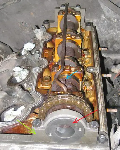

When piston 1 is at TDC on the compression stroke the camshaft position sensor "nub" on the left (driver side) camshaft (blue arrow) will be above the camshaft axis.
The timing slot on the end of both camshafts will be parallel to the head surface that mates with the valve cover.
I suggest that you confirm both camshafts are correctly oriented before cranking the engine. If you PM me your email address I'll send you a copy of the engine assembly instructions that contain diagrams of how and when to install the timing kit tools.

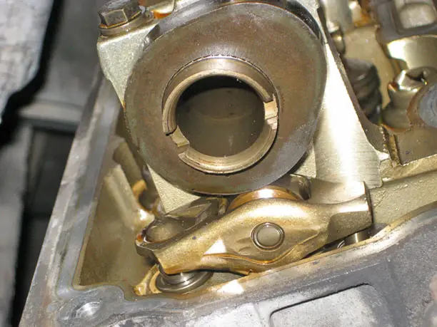

below the axis
I forgot to mention that the slot must be below the axis of the camshaft. The large circular segment should be on top and the small circular segment on the bottom. Otherwise the camshafts are 180 deg out of time.
