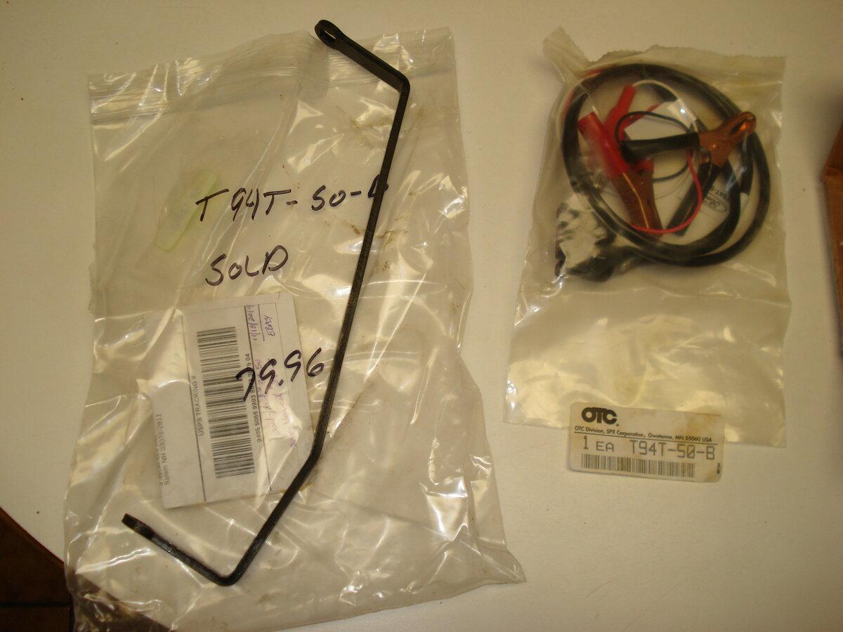

2. Ebay: CID Testing Wiring Harness T94T-50-B (Rotunda) From Ford service manual
And Sensor adjusting Wrench T94T-12270-A (10mm 12 point& 3/8 female drive otherside).

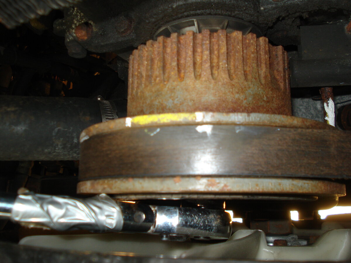

I rotated the crank around with the 19mm socket Looking up at the crank I try to find the 0 degree mark on the crank pulley. I had it at the 6 O’clock. (my pulley had two marks 10 degree ATDC and 0 degrees)
I then used my Caliper on the white envelope and set my caliper to 34 mm (that’s the 26 degree mark you want to be at) and marked the envelope. I used the X-acto knife to cut envelope to 34 mm. I then cut the 34 mm long piece to 1/8 wide.
I the used clear packing tape and tape to the cut piece of paper, to able me to pickup the strip of paper and tape it to the crank pulley.
I set one end to the envelope on the 0 degree mark and press white envelope strip on the pulley, which is at the 26 degree (34 mm from 0 degree. The clear packing tape is holding it in place; I then marked the pulley at the 26 degree mark with the white marker. I then used the yellow marker and highlighted the distance between 0 degrees and 26 degrees. I then rotated the 26 degree toward the pointer. The 19mm and ratchet remained in place. Picture 1

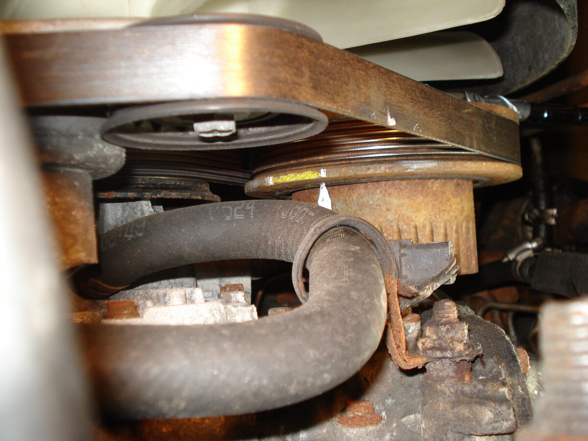

From the pass side wheel well; I marked the engine timing mark pointer with the white marker.
I then rotated the crank pulley around to the timing pointer. I stop short before the mark. I stuck a thin distributor screwdriver into the #1 spark plug hole to see where the piston was. I put masking tape on the screwdriver shaft at the edge on the head. I then continue to rotate the crank to where the 26 degree mark line up with the pointer tip and I then checked the screwdriver masking tape to see if it pushed out more; which it did. the engine was at TDC, if it did not I would have been 180 degree out. If it was 180 degree out, I would have to rotated the crank around (one revolution). Picture 2

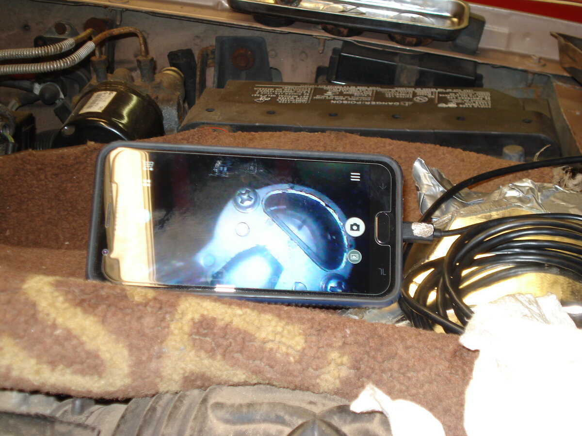

I used the borescope to look down at the Synchro (Cam Synchronizer) window. Picture 3.
The picture shows the orientation of the vane to the alignment mark on the window. One thing I did not do is, measure the voltage at this point with the CID Testing Wiring Harness T94T-50-B (Rotunda) Tool.

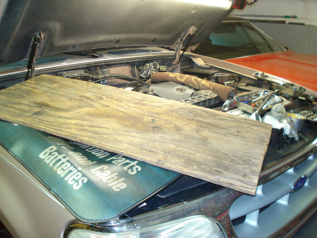

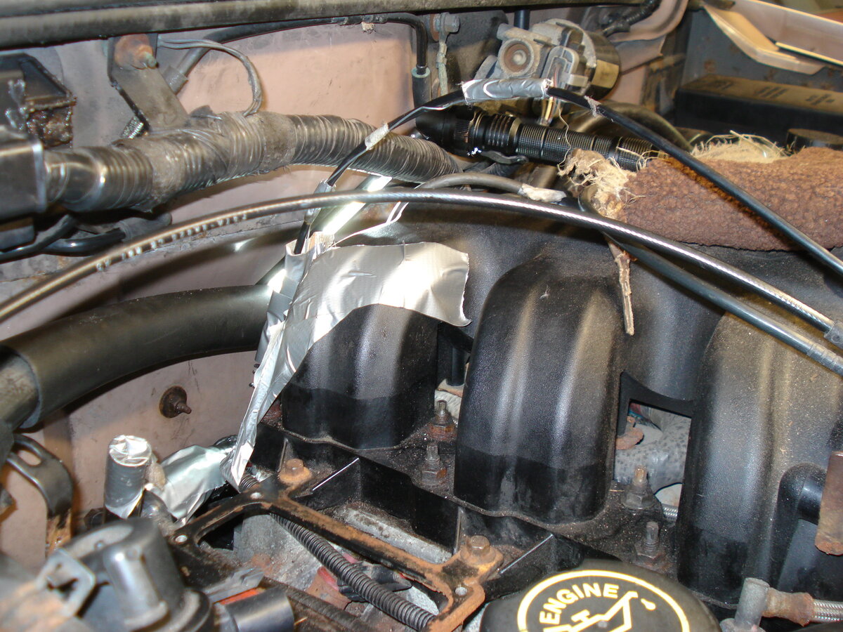

I duct tape the borescope to the upper manifold to keep it from moving. Picture 4
I duct tape the vacuum line up and at of the way and the same thing for the wiring harness.
I cut off the pop rivet on the AC line support to lift the ac line up.

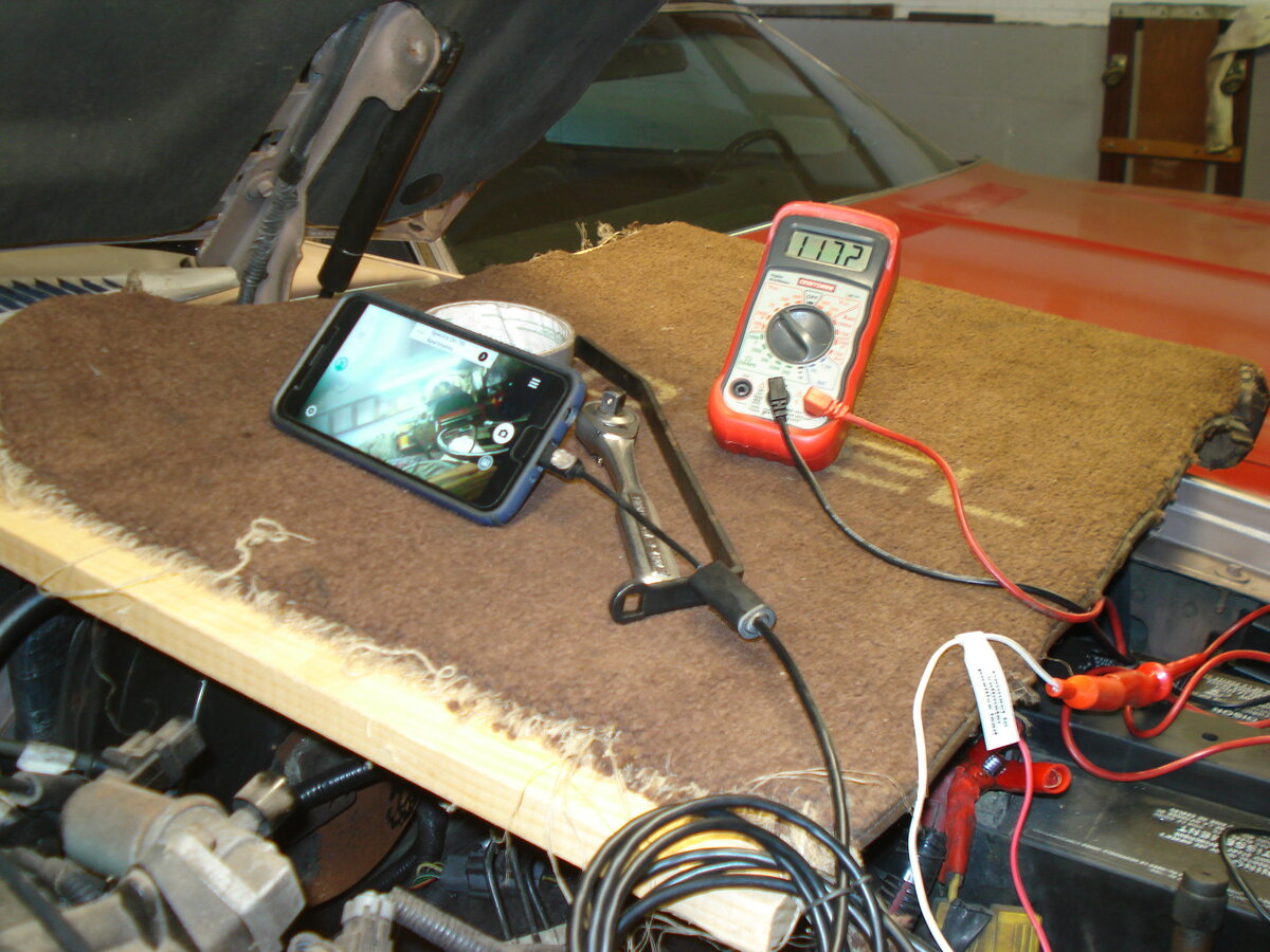

I duct tape a mirror to the fire wall.

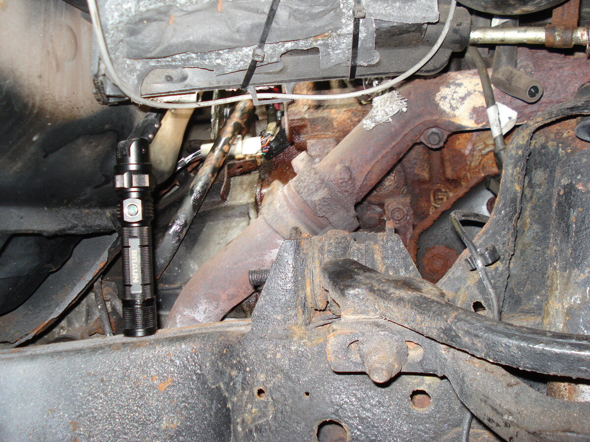

From the wheel well I place the Slim Bar LED Light on the exhaust pipe with bar light at the base of the mirror facing the Synchro. Picture 5.

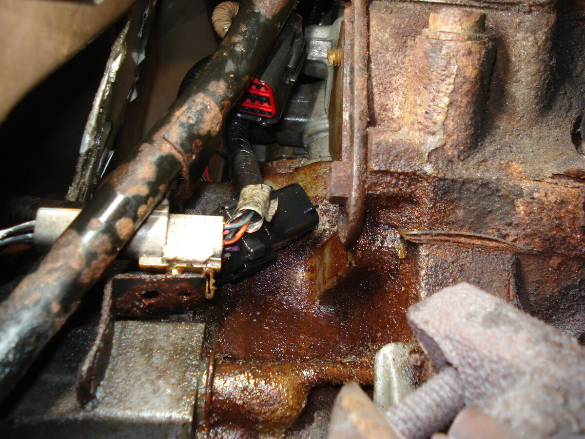

I disconnected the connector on the CID (Synchro) and tape it out of the way.
I used the Sensor adjusting Wrench T94T-12270-A (10mm 12 point& 3/8 female drive otherside). To break free or loosen the 10mm hold down bolt. I used a breaker bar on top of the wrench to get it to move. It was slow going (If the synchro (connector) was able to rotate to the Left
The problem I ran into was The Synchro was rusted to the Lower Manifold. I sprayed it with penetrating oil and I let it soak for a day or two. NOTE you need to remove the hold down clamp and bolt from the manifold to get the Synchro out.
From the passenger side wheel well
I disconnected the vertical connector on the side of the cylinder head. All need to do stick a long screwdriver in to depress the tab and pull drop. I spray it with silicone spray to help come apart. The top connector, to remove that, stick a screwdriver in at the base of the connector and it will slide up and off.
I remove the white retainer for the Oxygen Sensor and pushed out of place to make room.
I use the two 1/2 drive extension together and place it against the side of the Synchro and hit it with a ball peen hammer and it move. I was able to spray more lube at the base of the synchro from the wheel well. Picture 6. After a few hits the Synchro moved. The Service manual tells you to rotate the synchro side to side. Which I did. I rotated the Synchro connector to the driver side and note the orientation of the vane inside window Picture 7. The edge of the vane was at the second mark on the window. Picture 8. The original Synchro had two marks on the window. One was a half mark (removal Location, the synchro connector was turned to the driver side), the other a full mark (final location, at original location before removal).
The Synchro would not lift out. I use the two 1/2 drive extension together and place it against the underside of the Synchro and hit it with a ball peen hammer and it pop out. Picture 9 ( I was going to install a socket at the end of 1/2 “ drive extension in the reverse direction or cut a socket wall to give me more surface area on the housing of Synchro, but a couple of hits it more.
After it pop out, you have to have the connector turn to the driver side. I them Lifted the wiring harness running cross the back of the engine, while lifted and angle the synchro out the hole, around the harness and out. Note the vane does not move very easy away from it location when removing it from the engine.

Picture 1 looking up from under the crankshaft pulley
Picture 2 Looking at the pulley from pass side wheel well. From the side

Picture 4 - I Use duct tape to hold everything in place. The bore scope is the black cable tape to upper manifold
Picture 4a Picture from borescope of window on Synchro. This is the replacement with only one mark on the window.
Picture 5
- slim LED light on frame looking at side of engine
Picture 6 Looking from Pass Side wheel well with all the connectors move aside to see Synchro

Picture 8- Synchro connector rotate to driver side- for Synchro removal
Picture 9- from pass wheel well – ½” extension 22” long placed under Synchro to get to pop out. It was free moving side to side.

Picture 11- plywood across fender to front grill- this allows me to reach down behind engine to remove synchro.

CID Testing Wiring Harness T94T-50-B (Rotunda) From Ford service manual and
