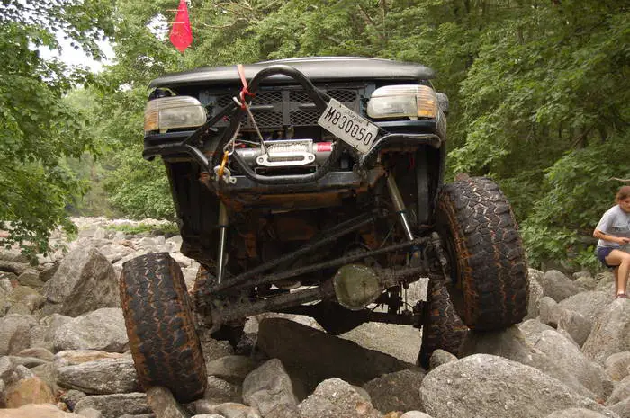

So all that's left is the grille. Is it mechanically needed? By that I mean, does it provide support for the headlights or anything else?
No the grille isn't really needd as the headlights bolt to the radiator support and surrounding sheet metal.
My 98 Explorer w/o the grille:
