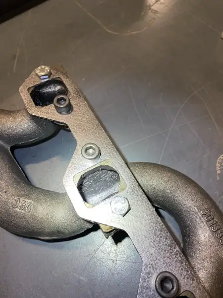

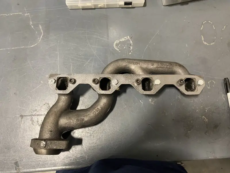

Just got in one of my cast manifolds to replace the stock welded ones. I bought the parts for a 98 with the EGR port because I don’t think there is another cheap option, so I’ll have to cap that off when it comes in. The inside of these castings is very rough, would it be worth it to get in there and clean it up a little before I install them?
Also, I think I’ll need to use longer bolts, at least 1 anyway. Dose anyone happen to know the lengths?

did you buy the Dorman replacements?
Yes the casting is ROUGH! Not as smooth as factory parts.
Yes it would benefit you to clean up the "leftovers" the cheaper Dorman parts have in the exhaust ports.
I would also recommend not using the gaskets Dorman ships with those manifolds, instead get some good Percy's or Mr gasket sandwiched aluminum style gaskets, available at most parts stores.
The new manifolds should have come with new bolts? You should be able to re use the factory bolts?
I have installed a couple of sets of these aftermarket cast manifolds, the price is good! The quality is decent....but with better gaskets and a little dremmel work they can be awesome for the $$$ invested.
You can get the fittings to close up the EGR port at most hardware stores it is standard NPT threads

I started cleaning them up last night with a dremel, I just lined up the gasket and made some lines to get it close.
They came with collector bots, but not the ones for the block. The stock are about 1/2” and it looks like I will need at least 2 that are roughly 1-1/2”.
NPT! Awesome, I’ll hit up Home Depot! and I guess I’ll pick up batter gaskets before the install this weekend. Thanks again!

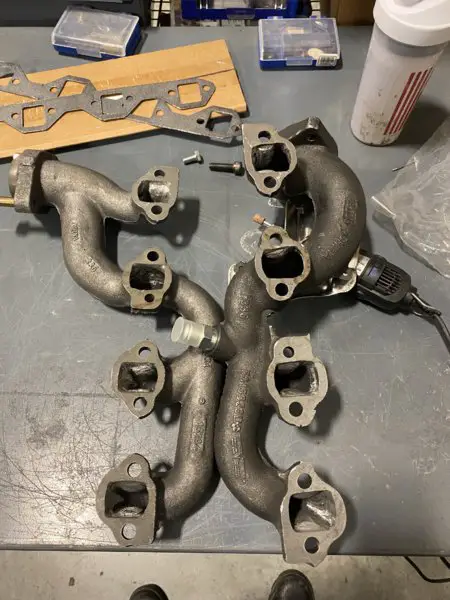

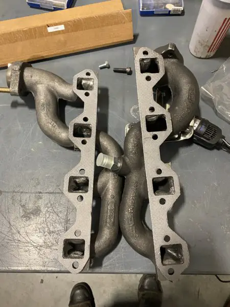

Progress!
before and after pics.
im calling these done. Now I just have to find that plug and the correct bolts and they should be on this weekend. I have already broke loose the manifold bolts so I know they come out without breaking. Going to start spraying PB blaster on the collector bolts tonight lol

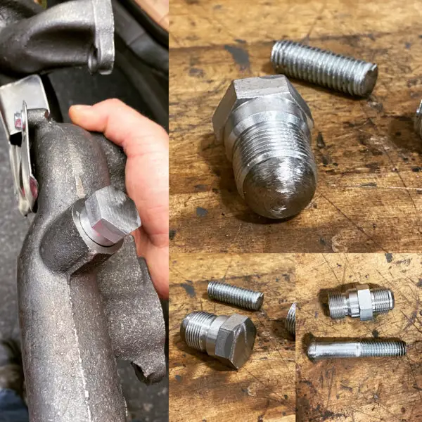

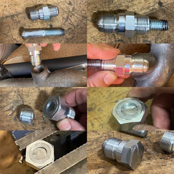

Also, I ran out of time to find a cap or plug for the EGR port so I ended up making one. I found a bolt that fit snug and ground the head down round, cut the bolt and coupling as shown in the pic and welded it together.

perfect!!

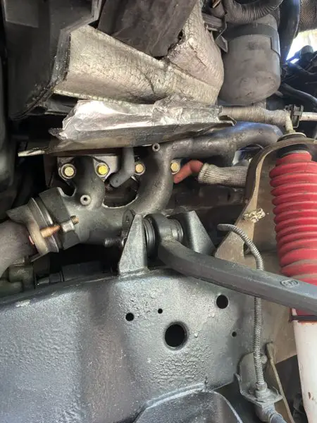

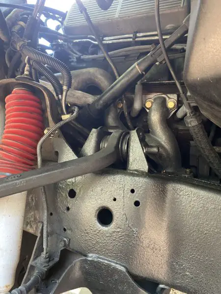

Got it all done. I didn’t need to heat the collector bots, I’ve been spraying them with PB for about a week lol. They came out with a little persuasion.
Oh yeah, I didn’t have to make a bracket for the dip stick tube, I just bent it into its new home.
All the local parts stores didn’t have the nice gaskets in stock so I just doubled the ones it came with... we will see I guess...
I ended up using 14 1-1/2” and 2 2-1/2” grade 8 3/8-16 bolts with split washers because I couldn’t find the fancy lock washers. Made the EGR plug. Replaces the plug wires. Can’t think of anything else.
If you want to do this be prepared to move the AC compressor, inner fenders, and disconnect the steering shaft. It’s pretty easy, 6/10.

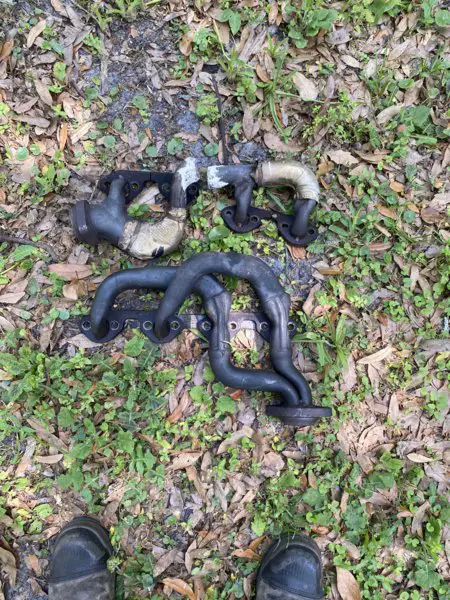

Those old welded manifolds make a nice coat rack in the shop, at least that's what I did with them
This way when I need to show customers the available upgrade I have a set of the old crappy welded ones on the wall

the cast manifolds allow twice the flow the old welded ones did.
If you look at the welded manifolds there are 3 combustion chambers that share one port the size of my thumb. In the cast manifolds that is increased to about 2 thumbs
