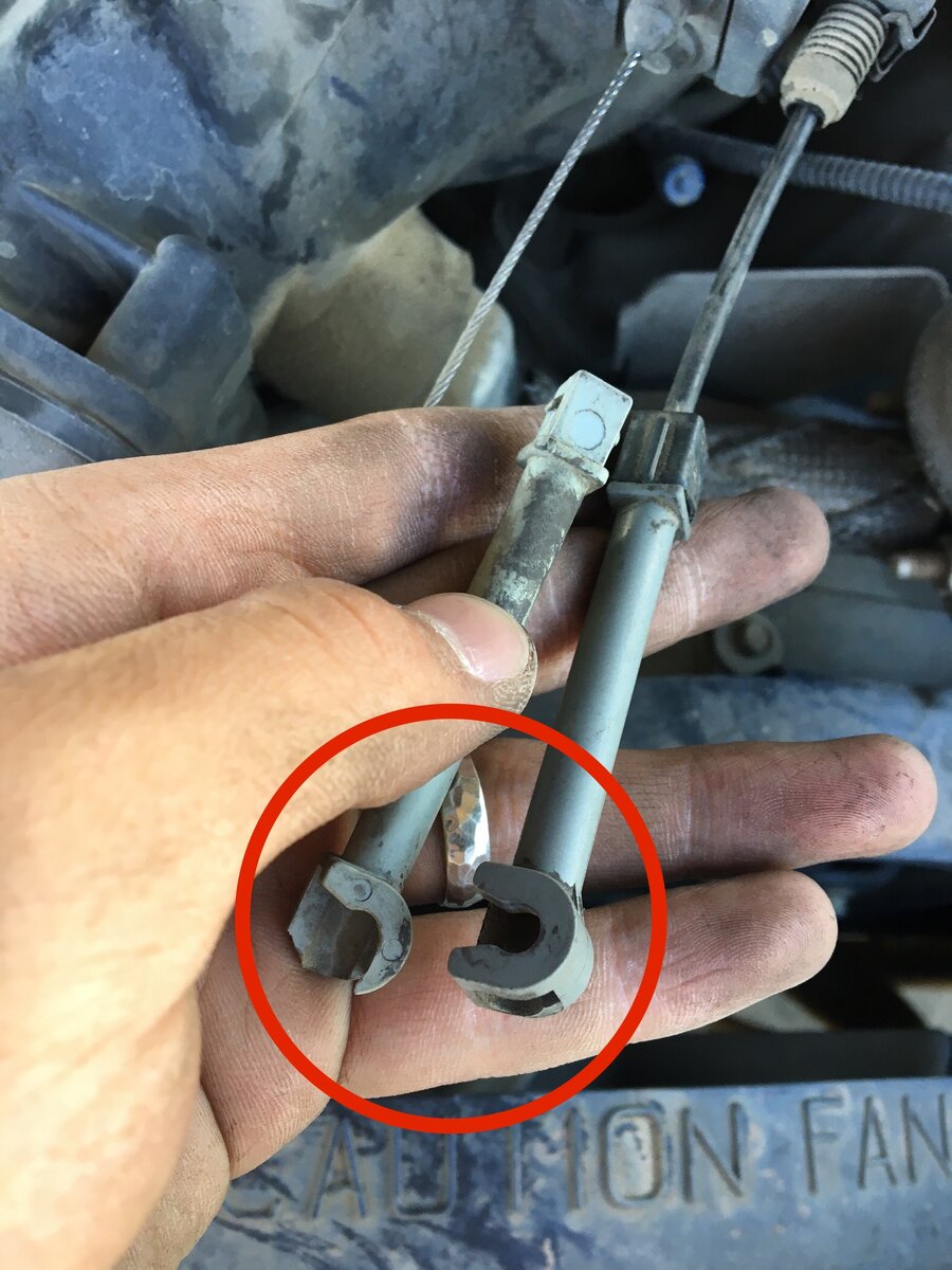

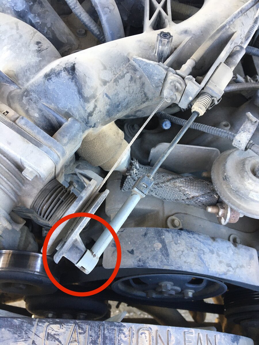

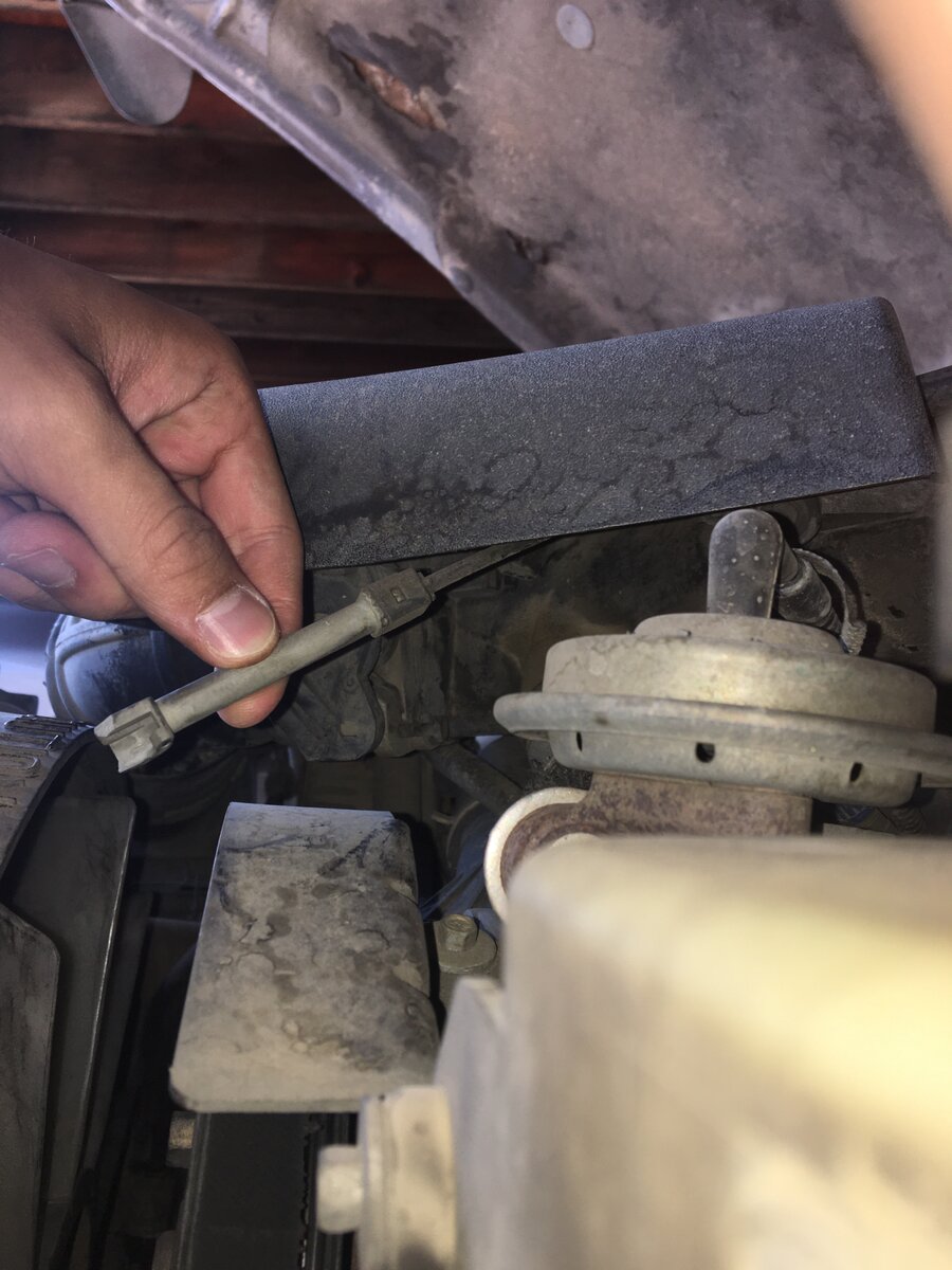

Hey, sorry for the super late respond, finally had time to try it out. So the static test passed for me but I have no idea how to do the dynamic test. Anyway I went and check the throttle body and this is what I found.
any idea what that wire is for?
Are you sure it's a wire? I am not familiar with the 4.0 SOHC, but suspect this is not a wire, but a broken or disconnected CC cable (the CC servo should be installed on the passenger side fender and connected to the throttle with a cable.
Yep. That’s the cable that connects your servo and TB—that is why your CC doesn’t work.
Thanks guys for your super quick respond! Well, I guess it’s clear now what the problem is. Is it an easy fix? Is it recommended to just go to a mechanic for it or is it something that I can DIY?
I can’t really get a good look at it, but remove the throttle body cover (that plastic cover that says 4.0 or whatever on it) and you’ll see where the cable attaches to an arm on the throttle body. It usually just snaps/pops on.
It looks like your cable end may be broken? The more seasoned guys here should be able to tell you if that is replaceable, or if you need to replace the cable. Either way, I’m sure someone on here has an extra, or just go hit up a pick ‘n’ pull junkyard.
Either way, you should be able to do this yourself over a cold one.
Thank you so much everyone for your input! It was super helpful and I got it fix. I went to pick n pull and got the part for exactly $1.53, changed it and hook it on. Works perfectly now!! Thanks again
