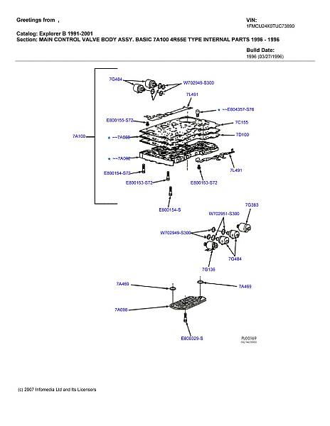

Guys at fastparsnetwork don't know what I am talking about when I mention SS3 or SSC solenoid. Is there a different name for it? How can I find out the part number. My X is 96 Sport 4.0 OHV with auto.
Thanks
Which one is SSC on the attached picture?
The 4R and 5R have 4 shift solenoids, an EPC solenoid and a torque convertor clutch solenoid. Just tell em you need a shift solenoid. ALL shift solenoids are the same and interchangeable.
