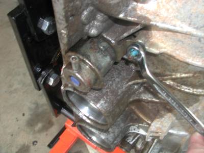

I assume that the modulator is same as vaccum diafragm..? As seen in this nice photoalbum:
I went out to see if there were any atf in the hose but no, it was dry...
Is there something I should think of when replacing, I assume this tranny has been on a shelf for some year or two, should I retension bands or so?
Yes that's the baby, try hooking up a vacuum pump to the valve or if no-one is looking hook a hose up and suck on it to see if it holds a vacuum. Band adjustment can't hurt quite straightforward lotsa help on this site. Did you adjust your TV cable?
