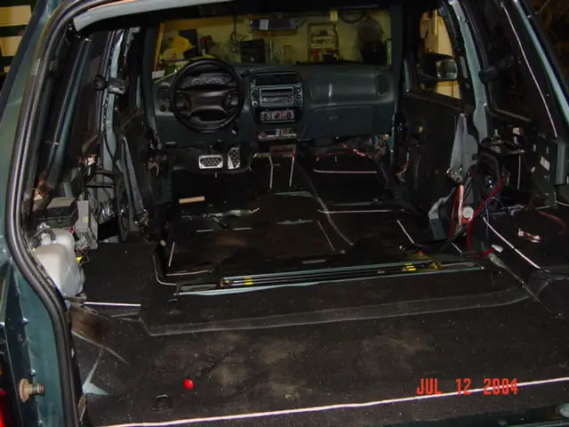

I took mine out and put some peel and seal(roofing material) on the whole bottom of the truck. It helped alot. I plan to do it to my newer truck too just around the console to help the same problem.

Because of its thickness, it wedged the console in better. Holding it tighter and taking away the play it had. Also, go through the console and tighten up all of the screws. Some of mine seemed to work loose.
