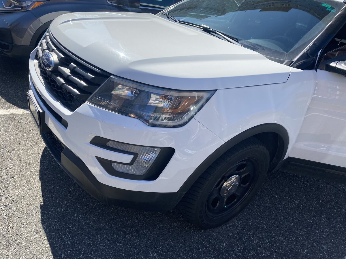

Can I tag along this thread? I don't want auto function, but I also have a 2016 PPV unit. Mine came with fog lights, but with no way to turn them on. Does anyone know if I simply replace the switch, would they work?
Can I tag along this thread? I don't want auto function, but I also have a 2016 PPV unit. Mine came with fog lights, but with no way to turn them on. Does anyone know if I simply replace the switch, would they work?View attachment 329101
Those are emergency warning lights in the fog lamp location. Something that ford offered as an option for the PIU from the factory. They are not fog lamps. Fog Lamps were not available on the PIU.
Thank you sir!! You saved me a headache!
