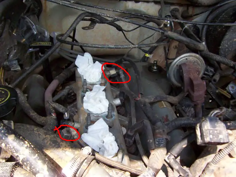

Ok have another question. When removing the fuel rail, do I have to disconnect the fuel lines at the couplings down by the fender well, or can I just unscrew the lines that attach to the rails, the ones in the picture below?
You can remove them there thats fine, just keep them clean clean clean.

You know you dont have to disconnect ANY fuel lines or fittings to change the gaskets. I guess you are wanting to change something else dealing with the fuel system while you have it apart? I just changed my upper and lower manifold gaskets a few months ago. I also put on a new fan, new t-stat, new serpentine belt and new radiator and heater hoses. If you need to change spark plugs now is the time as well. Also move the pulley on the water pump to see if it moves smoothly or if it makes noise. I thought about changing mine but didnt. I had to change it last week because the bearings were going bad, it would have been a little easier to do it when everything else was apart.
I disconnected the fuel lines anyhow, I was not patient enough to wait for responses :D
