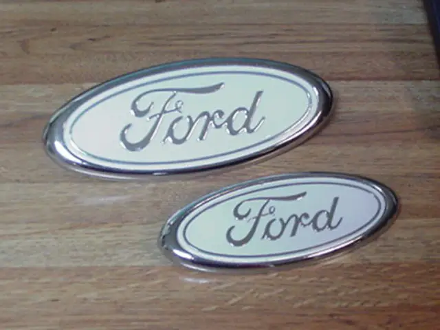

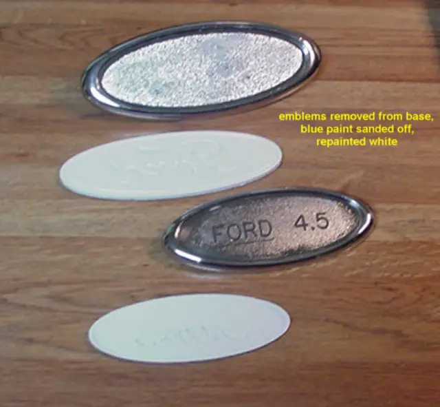

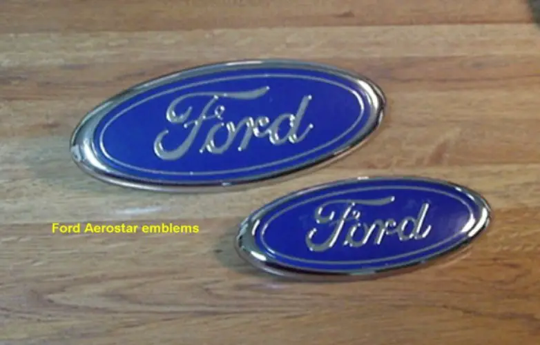

I'll let the pictures tell the story.

now that's cool!

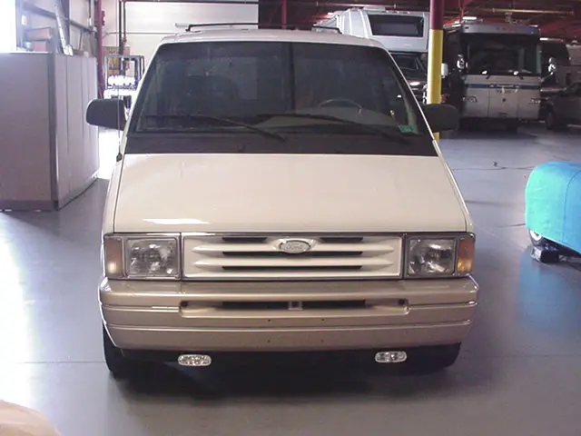

here's one more pic:

That's very unique! What kind of paste did you use to glue them back on? Where did you get the Aerostar lettering on the rear panel?
I let the paint dry for 2 days, then I put a little drop of Plastic Welder (15 minute set time) epoxy on each corner, and top and bottom center of each emblem, (west, east, north & south). Solid as a rock.
the "Aerostar" graphic came on the van, I've seen another one with it, so it must be factory.
wow, I didn't have to go through all that trouble!, I just removed the emblems without heating them, just pryed them off the base, (they had a soft sticky glue, looked like some type of white caulking to me), sanded the blue paint with wet sandpaper under the faucet, blue paint came off easily, and what's more, my emblems are not "stickers", so other Ford truck emblems must be made with a different manufacturing process.

i've done several of them. i have never heated them either. just pry them of carefully. i've always just sanded the back of them with 180, or 220, painted an let dry. i have even used a jack of spades from a deck of card for a background on the back side of it before gluing it back together for a forum member.
