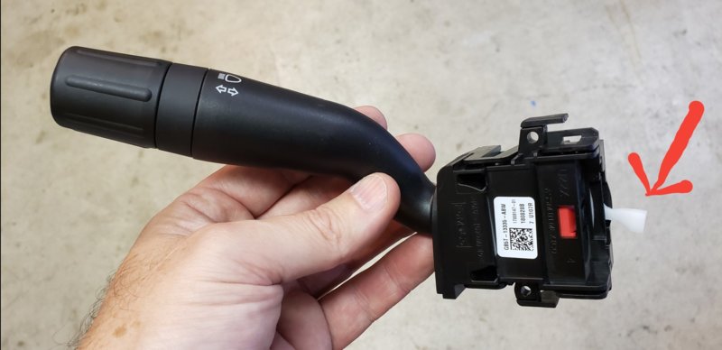

Well like Jon M said, the 2016 turn signal lever (which operates like the one I want and stays locked in the "up" or "down" position like the 2016 Explorer I looked at on the dealership lot) was only $26 at Autozone and was a super-quick plug-and-play install, but...
I don't know if my photo uploaded or not, but there's a small, white arm that extends beyond the body of the switch that my 2015 switch does not have. This arm is meant to be pressed up or down, presumably from making contact with a physical protuberance that turns along with the steering wheel, and thus resets the signal lever to the middle position after the steering wheel goes past a certain point - indicating that you've made your turn and now it's time for the turn signal to turn off.
Two problems:
1) In my '15 steering wheel assembly there just isn't anything to make physical contact with this arm to tell the lever to return to the middle position. I fashioned a small piece of ABS plastic to act like an extension and zip tied it onto the end of the arm so it makes contact with a small "nub" that rotates with the steering wheel assembly so that it pressed on the arm and did indeed return the signal lever to the middle position after a turn, but...
2) Even when returned to the middle position, the turn signal does not shut off. It just blinks and blinks until you physically cancel it by slightly depressing the lever in the opposite direction.
I suspect that in my 2015 model, there's some sort of position sensor in the steering wheel that electronically tells the turn signal to shut off (since the signal lever always returns to the middle position as default as soon as you use it to make a turn), whereas the 2016 switch uses that white arm to physically return the lever to the middle position, So I can only assume the 2016 switch isn't compatible with whatever electronic wizardry is going on inside the 2015 steering wheel assembly.
I hope that makes sense.
I'm not sure what the dealership is planning on doing with my $400 to make it work the way I want (and I don't think they know for sure either), but it's definitely not something a $26 part will fix.
Thanks, everyone. - Tony

I think this is the first time I see a real attempt to change this. A suggestion that might be worth to try, in SCCM As-Built Data, ForScan, did you try to change type of turn signal (On Until Canceled - OUC - link to F-150 Thread about it)?
SCCM 724-01-01 xxxx xXxx xxxx
For a stock 3-Flash turn signal, your setting should be "7", try changing it to "6".

What was the part number of the switch you bought? I assume it does not have the lane change feature anymore
Duralast SW12067.
Yes, it had the 3-blink lane change feature.
I have no idea, sounds too complicated for me. LOL
