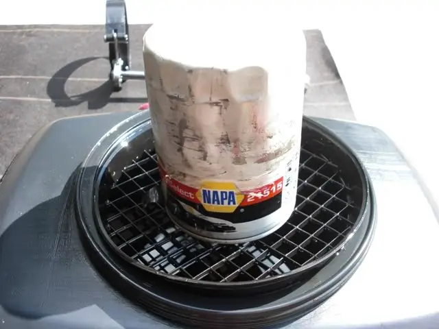

Everything was fine until this morning when I went to get the damn thing off. I slipped the band wrench around it and tried to turn it but it was in there good. After much grunting and groaning it looked like the band had bent. WTF? After I fussed around getting it off the oil filter I found that the entire filter had bent. :eek: Furthermore this caused a small hole to form in the side of the filter letting out just enough oil to seep out and making this bad situation worse.
15 more minutes of cursing, grunting, and bending the band-wrench back into something that resembled a circular shape again produced this:
With all the Motorcraft and Fram filters I've used, I've never had this problem before (and we've had to grunt some of them off, especially those put on by the dealer or a tire place). Therefore I conclude that the NAPA ProSelect filters are made from cheap-ass metal that bends way to easily.
It sounds like it was installed too tight. Spin it on just until it touches the block, not snugged on. From just barely touching, tighten it by hand until well snug. Note where it began just touching, and don't tighten it more than 3/4 of one turn. That is the maximum, a little less is good also.

As for your old filter you more than likely did put it on a bit to tight.

I usually do that "hand tighten + ¾ turn" but for some reason this one got comfy. Maybe I did get carried away, who knows, I actually haven't changed the oil since May but I hardly drove it over the summer and then Hurricane Gustav made me put it off even longer.
Sometimes these quick-lube places gorilla-fist the thing on there. My dad has become big on those places and one time I struggled with one, but it didn't bend nearly as bad as this. This one went flat on one side.

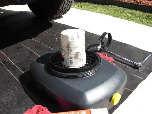

These two pictures give a better look as to what I'm talking about, you can't see it in that other one:
I have had that happen a few times. It's always been with another person's car or a cheap brand filter.

Jackal, I doubt you got it one bit tighter than usual. I have no doubts it's due to the cheap filter. NAPA Gold is a Wix...and a very high quality filter. I have no idea what you have there...but it's obviously not good. I would also stay away from Fram like it has the clap. If you cut a bunch of filters open and inspect them, it will be an easy choice for you.

Supposedly the ProSelect is also a Wix filter, but a cheaper version. When I looked it up last I think it said the Gold has a fiberglass element, whereas the ProSelect has a paper element. However I'm also inclined to believe that the overall construction of the filter is more flimsy than the Gold series. I don't know, all I know is I used two Golds prior to this and they didn't do this.

On a side note, where did you get that oil drain pan? I like it.

I think I got it at Wal-Mart, but I might have got it from Advance Auto. Don't remember, its been too long now. :p:
I like the fact of not having to clean it out every time, you just close it up and bring to the store and drain it out. Plus the plastic grate keeps you from dropping the drain plug into the oil and having to fish it out.
The only drawback is the size of the drain opening, I did "miss" once... :D
