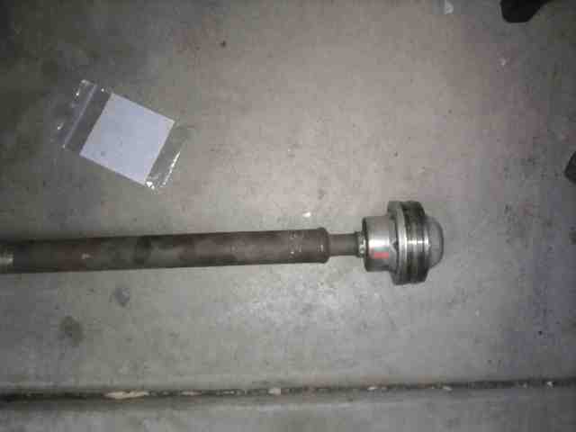

My money is on the front drive shaft if it looks like this one. The CV should have a lot of easy movement. If it barely rotates or not at all you will need a new one. If it looks nothing like this one just ignore me please :D

good point, makes sure that driveshaft is ok, you tested it too with xfr case. . in way.
stuff still there i would expect some symptom . .
