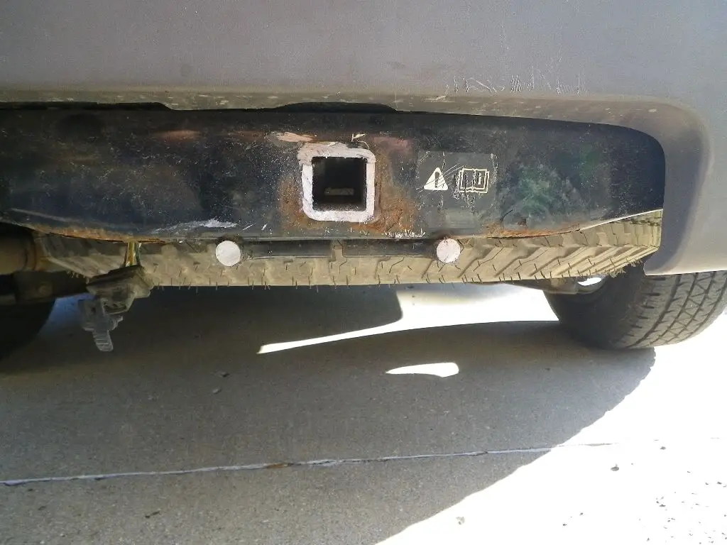

I ordered a class II aftermarket hitch to mount below my current class II. I agree, it looks goofy, but my class II is welded on and I really don't want to mess with finding a Ford replacement class III and paying for the welding work. Based on recommendations from other posts, removing the class II and installing the aftermarket is a bad idea because I would lose bumper and frame support. So I am wondering if anyone has tried to cover the old class II with some sort of filler plate that would match the bumper color and be hard to notice. Anyone have any experience or ideas? I'm not sure how to mount a plate, maybe into the hitch receiver?

Yeah, it is a bolt on design but a previous owner must have had it welded. There are welds on the top and bottom where the hitch bolt plate hits the side frame. I don't see any damage to the hitch bar or the frame, so I am not sure what the reason. My problem isn't cutting it out, it is timing. I am in a pretty rural area and none of the junkyards around here have a class III and I wanted to be set up sooner rather than wait for something to show up. I guess the class II were more common. $500+ for OEM from Ford is not worth the slightly awkward look of the aftermarket (for me, I'm cheap).

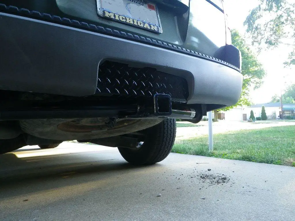

Just an update to show you all what I ended up doing.
First I cut the old hitch flush and ground it down flush.
Installed the aftermarket hitch.

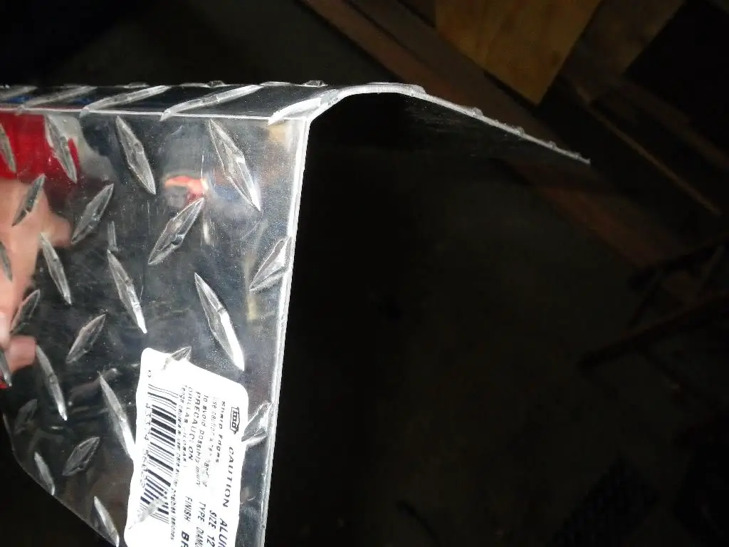

I bought some diamond plated aluminum and bent it at a 90 degree and cut it down to size.
I was able to slide the aluminum plate behind the bumper and in front of the frame with the angled piece between the frame and the new hitch.
Once I got everything square I put two screws in to hold the piece in place, taped and painted. I wanted to paint before I put the piece in, but I was worried I would scratch the paint because it was a tight fit. Here is the finished product.
I think it turned out pretty good and is not too noticeable. Definitely better than having both hitches showing.
