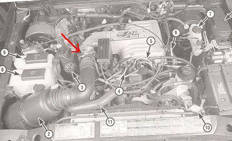

My old Baretta had a very bad carbon problem and I'd have to tear apart the throttle on that one and clean it just like you mentioned. But, on the 5.0X, where is the TB? I looked it up in the Chiltons (at the library, can't check those books out) but I just can't find in on my truck. Any suggestions?

real easy to find... just follow the intake tubing to were it stops. this is the throttle body. remove tubing, and you have good access.
