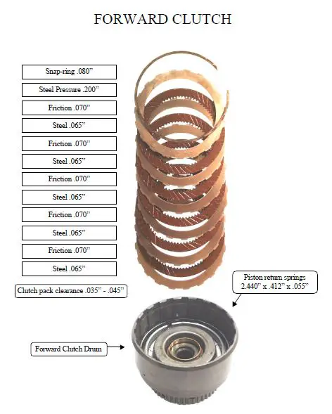

I am in the process of rebuilding my 5r55e ford explorer. This is the first time so I am going very slowly. Inside my forward clutch drum my service manual states that I should have approximately .050 to .070 clearance between my last of the disks and the retaining ring. I have only .008. I also installed a new replacement rubber from the kit in- between the first metal disk and the piston that acts like a cushioning spring. Is this cushioning gasket acting like a variable that gives me my required clearance? The manual says that if I don't have the clearance then I must change the thickness of the retaining ring. My gasket kit did not provide a different ring.

If I were you, I would pull out this "cushioning spring/gasket" you are talking about and then remeasure clearence, if it's within specs without it, and when you pulled the clutch pack apart it didn't have one to begin with and doesn't need one, I'd just get rid of it. If not, you definitely need a new retaining ring (tbh you could probably pick them up in most sizes at most tranny shops, just say you have x thickness and need y thickness, give me a z thickness ring x D)

Make sure after you install the clutches and steels into the drum that you seat the clutch pack against the snap ring. I do this by turning the drum over and give it a good bump on the table or air check it on the center support. Maybe this will show you more clearance and its not as tight as it appears. Measure the frictions and steels to make sure they are the correct.
I have never seen this drum without the rubber cushion ring in the piston so I wouldn't leave it out.
