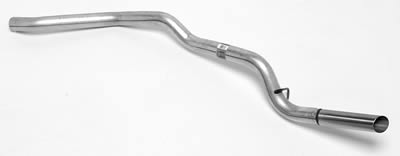

I've decided on the hooker maximum flow muffler, they make a dual 2.25 inlet, single 2.5 outlet. So that dynomax pipe is pre-bent 2.5" for the X? If so life got alot more simple cause I can do it myself
FYI, this is the complete Walker Dynomax cat-back system (part no 17352). I'm not crazy about the way they merge the two pipes into 1. But it gives you an idea of what your system could look like if you cut off the factory system, then weld up or bolt on an after market muffler with the pre-fabricated tail pipe. As far as complete systems go, I guess that MAC & Gibson are the two most popular. Price aside, if money is no object, Gibson makes a stainless system.
96-2000 V6
96-99 V8
Pre-Fabricated with mandrel bends.
Tubing Gauge 16-gauge
Outside Diameter (in) 2.500 in.
Tubing Material Stainless steel
Tubing Finish Polished
Hardware Included No
These Direct Fit Tailpipes from Walker are specifically designed for your application. They are perfect as replacement pieces or if you are putting together a new exhaust system for your vehicle.
Dynomax Performance warrants its products to be free from defects in materials and workmanship for a period of 90 days from the date of purchase. Exclusions to this general warranty include Ultra Flo mufflers (lifetime), Super Turbo mufflers (lifetime), exhaust systems (mufflers lifetime, pipes 90 days), and catalytic converters (internal components 5 years/25,000 miles, whichever comes first, external neck and shell 5 years/50,000 miles, whichever comes first). Dynomax Performance will not be responsible for freight charges, labor charges, other expenses or inconveniences, or consequential damages occasioned by failure of the product, or for breach of any expressed or implied warranty with respect to the product, other than as set forth herein. In addition, this limited warranty becomes void if products show evidence of: Mishandling; bending or mutilating of parts; burnout resulting from improper tuning; visual rust or rust-through as the result of an external wrap or coating on the header not applied by Dynomax Performance; use contrary to applicable instruction sheet; shipping damage; and repairs performed by those other than Dynomax Performance or their authorized representative. Paint, gaskets, bolts, external (visual) rust, rust-through, and cosmetic appearance are not covered under the terms of this warranty.

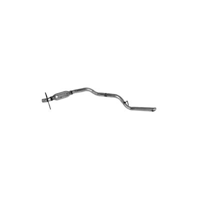

I also see Walker 46959, which looks like it is a direct OEM replacement with a 2.25" pipe and a resonator.
