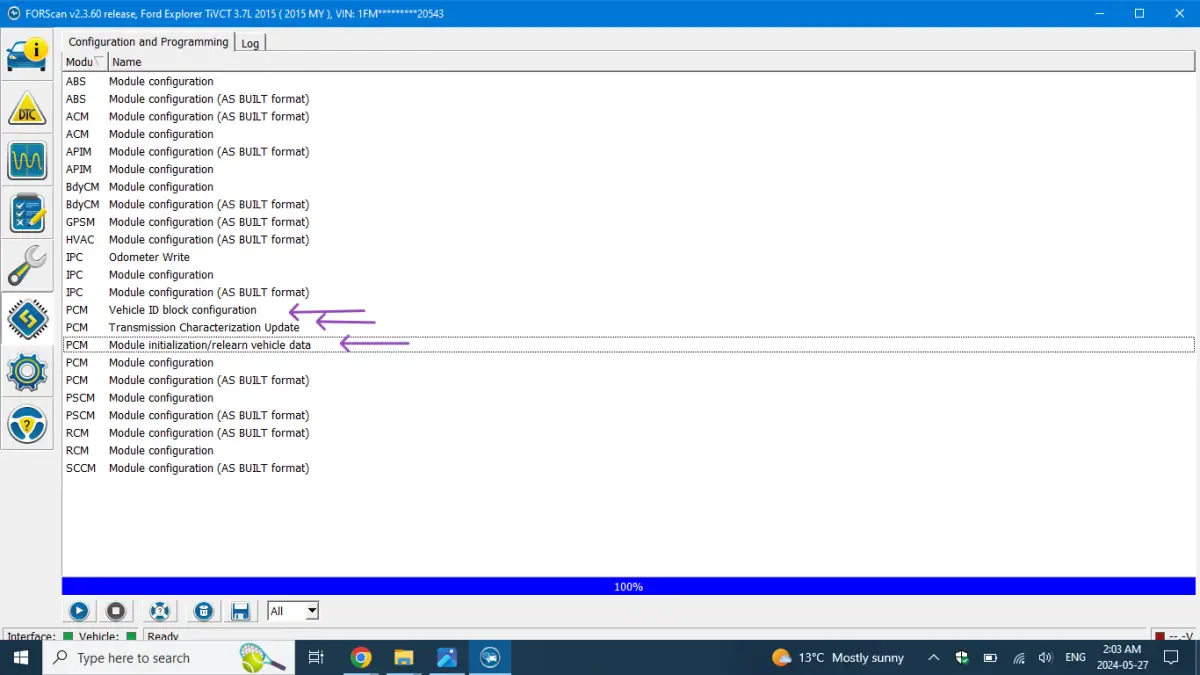

Please, can I ask:
Can you tell me your opinion about all these things?
Is it okay if I do this programming?

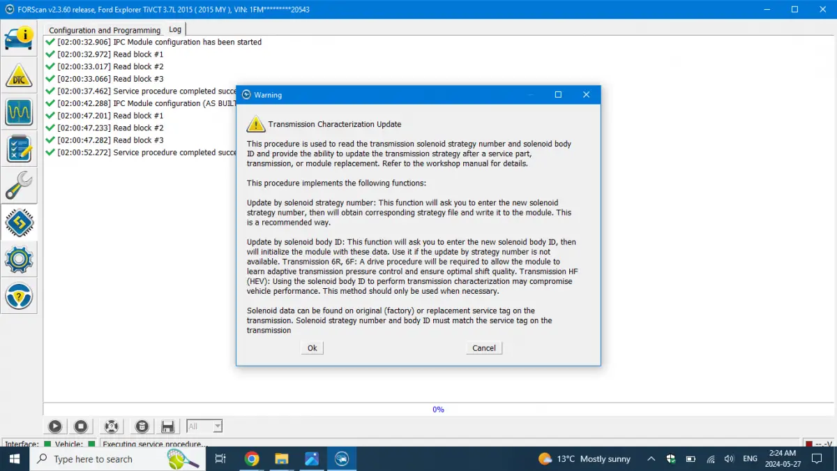

Hmmm. Sounds like someone did some trans work to it before you got it and didn't know how to or didn't program it correctly. I have absolutely zero trans knowledge. From that popup in FORscan though, it sounds like you need some code or something from the solenoid? You may be able to drive it so it learns, but that way should be used as a last resort. That tells me that it sounds like you may need to open the trans up to get a part number or something off the solenoid. I don't know, I would take it to a reputable transmission rebuilder and see what they say in your area.

Hopefully if they replaced the solenoids they updated that sticker for you. If not, sounds like you have to use that learning version as a last resort. Fingers crossed they changed that sticker as well, or at least left it in the glove box.

Interesting..... So, googling that code took me to a few post about tuners. It sounds like all you need to do is reflash the trans.... Rather than using that video, use this link, it's got a better step by step on how to do it. You will need that solenoid code from the transmission though.
It sounds like when someone flashes a tune to the PCM, it corrupts the trans data and it just needs to be be reprogrammed.

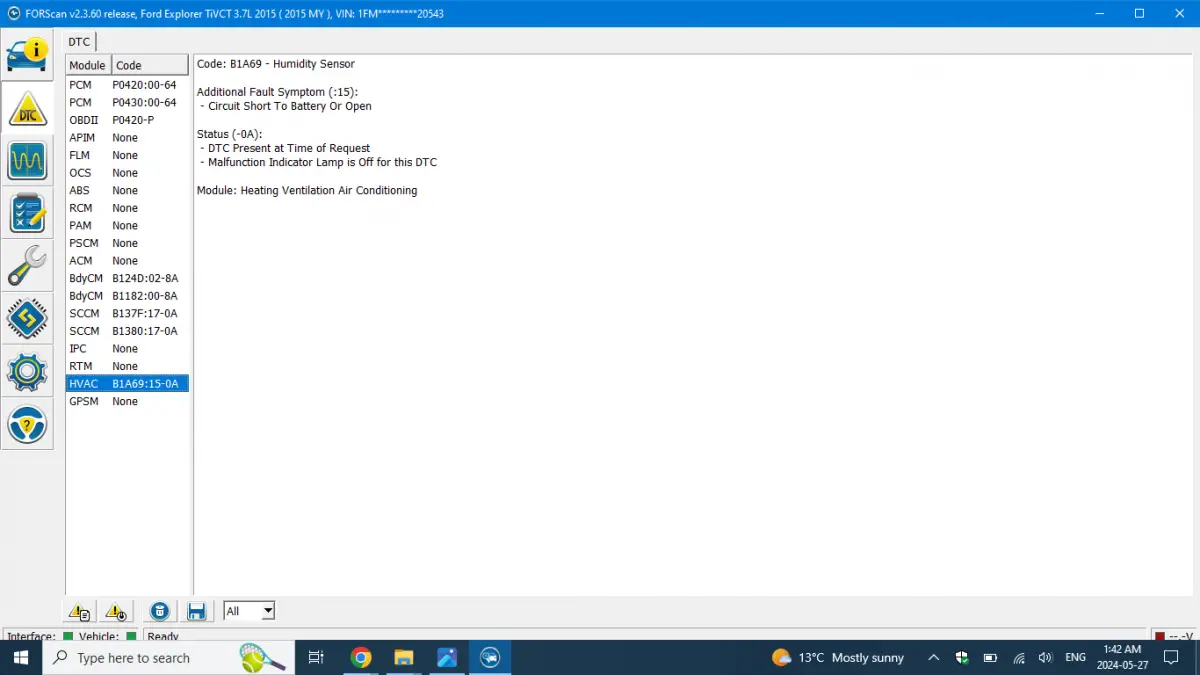

I disconnect the battery for two hours, I did Self-Test, here are the results!!!
