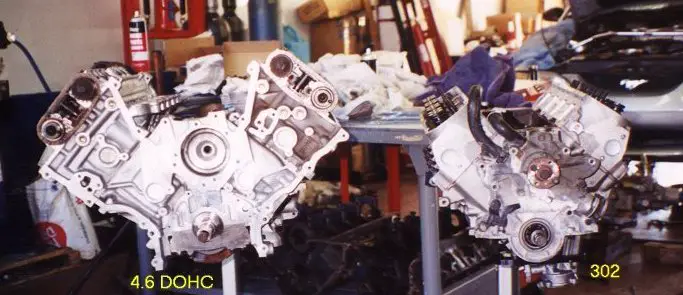

The major..well major or the major problems is that the new mod motors are SSOOO wide. You will have a very very hard time fitting it between the frame rails.
Ah the typical pic... a 4.6 vs 5.0... Older is better.

I really don't think it's "possible" I know with enough cash you can do anything, but it'd probably be more trouble than it's worth. It's just too wide.
