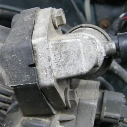

Ok, thanks. is there any specific way i need to clean it? or things i need to do or not to do
unhook the wiring, than unbolt it, than clean the cavity on the other side with some sensor cleaner , available at any parts store,
